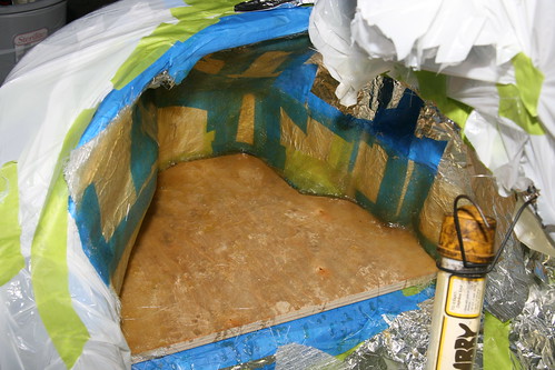

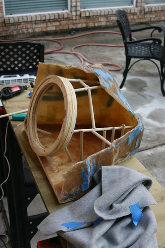

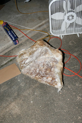

Old Box
New Box

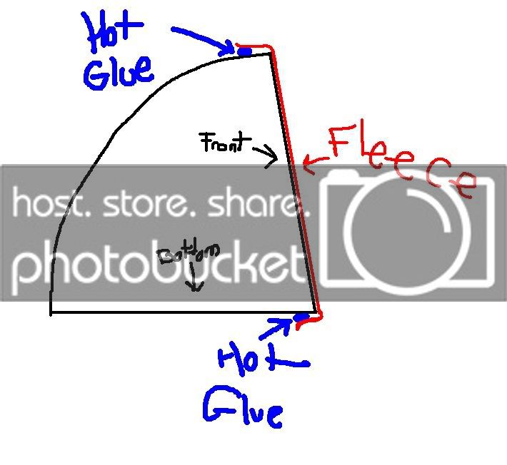

ok, here is a little picture of what you should do.
basically you want to wrap te fleece around it. instead of using staples, use hot glue. imo start at the top.
leave at least an inch from the tip of the enclosure to the point of where you are adding glue. you want to add resin to that area later on when you are wetting the fleece, well what you need the ice for it to help speed the cool down process of the hot glue, basically at the top lay a strip of glue maybe 1" long, press the fleece in, then rub it down with the ice to cool down the hot glue from being all jelly and shit.
then stretch from that area to the bottom of the enclosure and then lay a strip of glue again, press in the fleece, then cool it down with the ice. now, just work your way around the rest of the enclosure, remember to leave at least an inch of space between the glue and the tip of the enclosure. when you resin that area up the fleece will bond with the outserskin of the enclosure.
before you put on the fleece have you set your speaker ring and dowels in??
I am about to go there and make the baffle and dowels now. I assume you can just hot glue the dowels into position? The box will be curved awkwardly in the right corner. I didn't think hot glue could hold the strength of the fleece especially after stretching it? I guess i will find out.

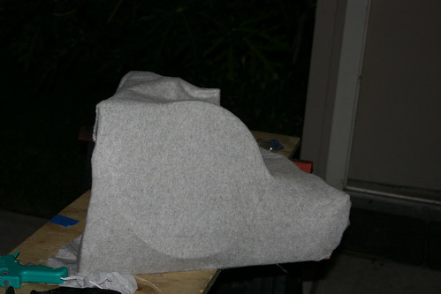

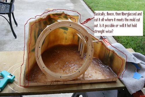

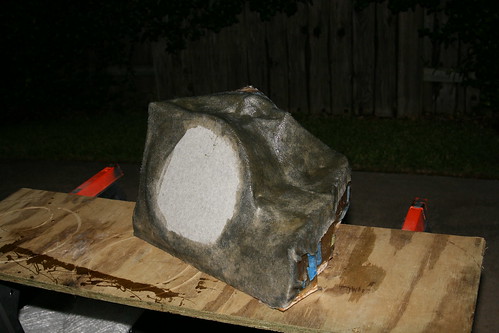

Here is the box fleeced with resin.

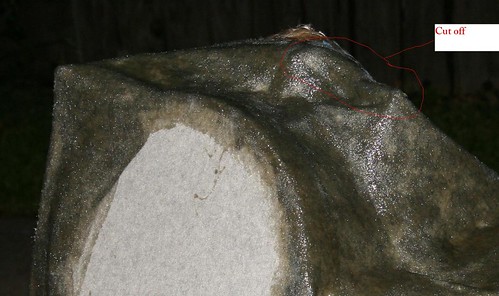

After throwing the fleece on with resin the box would barely fit into the trunk mold anymore. I guess i will have to cut it (Picture below). How many layers of fiberglass must be laid onto the fleece? I plan on doing a layer in the inner areas of the box as well.
