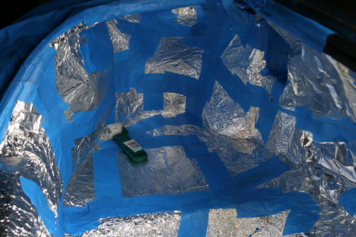

This is my first project doing a fiberglass box install for a S2000 using Bondo resin and mat (Cheap, yes I've read up on it a long time ago but i can't convince my friend otherwise) and i have several questions. Here is a picture to begin with.
My first question is the foil acts as a an easy mold removal correct? I shouldn't have to spray it down with Pam or Vaseline or should i still?

I haven't done too much with fiberglass but have some first hand experience. The foil will work as a release but you may get some foil stuck to your resin and just have to peel it off, some pieces become more pesky than others but in the absolute worst case you could easily sand the foil out of the fiberglass.

1st you put masking tape over the whole area you are glassing. 2nd put down foil.(it helps if you spray the masking tape w/ spray adhesive to make the foil stick) 3rd break up mat and put it every where you are glassing. 4th mix glass and glass the area. do atleast 4 layers.

after degreasing the entire wheel well, i would lay multiple layers of good masking tape. make sure to overlap the pieces and then criss-cross the next layer of tape perpendicular to the first layer, to reduce the chance of resin seeping through.

from the pic, i would lay a trash bag over and spray it down with something oil based. then lay presoaked matt down. the bag is easyer to release than foil. i personaly do not care if the tape, foil, or whatever i use sticks to my mold, as long as i do not make a mess or stick to trunk.
