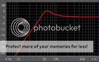

I'm thinking of just doing 1 15" ported, giving it 4 cubes to its self, according to bassbox pro it will be louder than 2 sealed.
H: 14"
W: 22"
D: 25"
Will have the sub firing up and the port coming out the front into the cabin when the seats are folded down. Like this will have the back of the sub almost right up against the slot port which has these dimentions which should tune it to 34Hz.
Port:
H: 4"
W: 12"
L: 20"
That look okay?
This is the Bassbox 6 graph of it's response. Look good for a couple of comps and loud daily listening?
Thank you,
Anthony

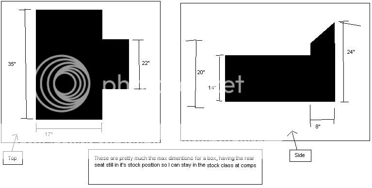

Well, I'm not sure that I want to get a 15" L7 anymore. Anyone that has seen the back of a 2nd gen AWD dsm knows that there isn't much room. let me draw you all a picture.
Those are just about the max dimentions without dipping into the spare tire well. Seems to me to be close to 4 cubes usable space. With the 14" heigth there is still a little room for air to move. I am thinking about using that box right there and having the sub(s) on the top firing upwards to the top of my trunk and my hatch glass the farther forward they are.
Where it makes the jump from 14" to 20" is the start of my rear glass, all the way up to 24" leaving me little room to see out the back window. I would like to not have it go above the rear window, it will put me in a higher class for comps. Making it hard to see also.
Where the box gets narrow going from 35" to 22" could be wider but I would have to build over a small bump because that is where my shock towers are and the plastic on them slopes down into the trunk/hatch.
Also, there is a little room on the back of the box as the back of my car curves, leaving space to have a port be back there having enough air to "breathe".
