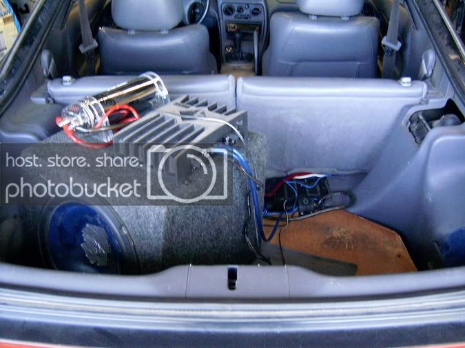

My trunk/hatch is like so... H:14"xW:35"xD:17".. Wait there's more! It's just that after that my shock towers get in the way. You are coming up behind the rear seat here. So there is more room because of it opening up. H:20" to 23"xW:22"xD:8" Those dimentions get connected to the others, because of it narrowing up. Let me get a pic so you get an idea..
Old pic, old system lol:
I just want loud ****it! Not sure how to go about it now with only this much space. Please help, I'm desperate! lol

If you really want loud i would reco you maximize your trunk (use the entire space that is). By the looks of your old set up it seems that your not looking for a nice looking system but something that will POUND. If I had that car I would have my subs facing up with the box eating up the entire trunk area and have the amps built into the box encased in plexi. If you looking for some designs check out some other sites, just look through the images and you will find something you will like.
I do want it to look nice //content.invisioncic.com/y282845/emoticons/wink.gif.608e3ea05f1a9f98611af0861652f8fb.gif and be loud! //content.invisioncic.com/y282845/emoticons/wink.gif.608e3ea05f1a9f98611af0861652f8fb.gif As long as I can keep my backseat in. I can always fold it down but I need the ability to use it when possible. The subs facing up where? Firing directly at the rear window by the rear seats?
Yup. have the subs facing directly up. The box should only go as high as the trunk and not flush to the glass. You will be needing that space for the sound to bounce off. Trust me by maximizing the air space needed for the subs and using up your entire trunk will give you the best sound and a cleaner look. what you could do is have the amps flushed into the box so when you fold down the back seats the ams are exposed.
Think about it... best sound (due to max air space), cleaner look (you can only see one big box with subs facing up) and you don't have to even touch your back seat (coz you will only be using your trunk space.
What ever your subs need. If you want the bass hard that thumping i would seal it but if you want it deep and crawling i would port it but it depends on what kind of subs your gonna use. If your gonna port it i suggest you put the ports on top facing the same way the subs are so you get max sound out of it
