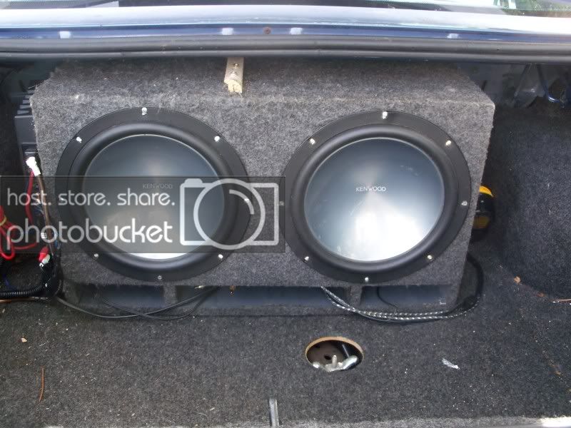

Thought I would post what my set-up. Before "flaming" me please keep in mind I am new to car audio.
Subs- 2 12" Kenwoods 400watts max rms 1200watts peak
AMP- PYLE PLA2378 2 Channel 2000 (will be replacing my chepo sony xplod amp when it gets here in the mail)
Cap- Monster Cable DigiCap
Head Unit- Sony Xplod CDX-GT24W
I will post a video as soon as it gets done uploading.
Feel free to post your thought
Feel free to post your thought, but PLEASE dont FLAME me

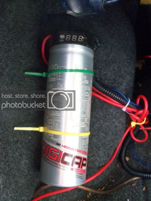

Lose the cap, otherwise... as long as you're happy with it. Good.

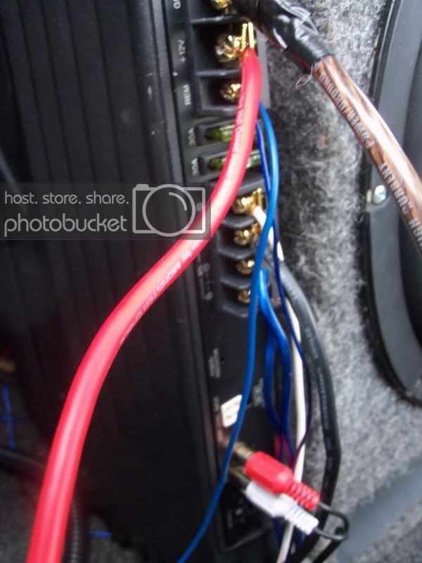

edit: may want to upgrade your power wire size as well and clean up the wire sticking out from the terminals on the amp, don't want your + and - touching.
When i dont have the cap installed my lights on the car dim to nothing, when I have it installed they don't. Ive been working on the wiring slowly. What gage wire would you say to use?

for wiring - biggest your amp you plan to use will take and instead of the cap, buy another battery like a kinetik hc600 or hc800 or bigger, all the cap is going to do in the long run is add something else the alt will have to charge. it's like putting a bandaid over a 6" gash across your chest. it won't work for very long lol.

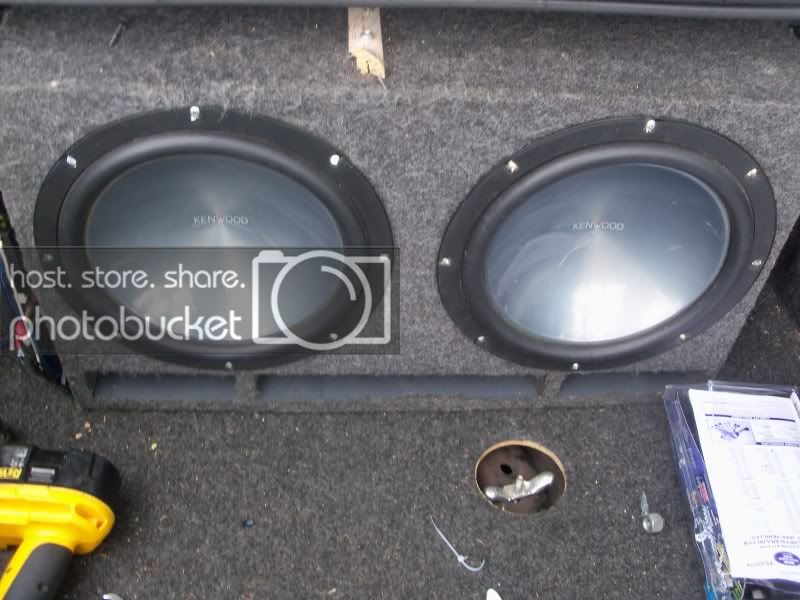

kenwood subs = very low end but... if that's what you like great.
prefab box = very low end....
10 gauge power and ground with copper hanging out = extremely poor installation

I'd say out of a 10 with 10 being the best you are down around 1. You asked for our opinion and I'm giving you mine. You have a lot of room for improvement. It's good to see you enjoy this hobby. Stick around and learn. Lots of improvement can be done to your system with very little expenditure. (new enclosure, upgraded wiring, etc) Then once you get the money you can improve your subs, amp, etc (and probably yet another enclosure).

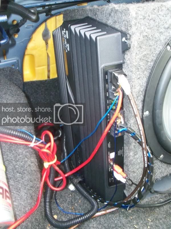

I decided to circle some of the "WTF" areas of your install //content.invisioncic.com/y282845/emoticons/fyi.gif.9f1f679348da7204ce960cfc74bca8e0.gif

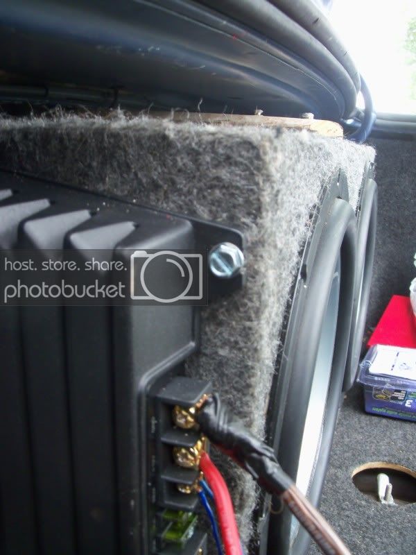

1. Using that dinky *** drywall screw at a 45 degree angle is NOT the proper way to mount an amp.
2 & 3. You need to do some major overhauling on your wire terminations. There shouldn't be crazy strands of wire going in every direction, especially on that power wire. If one of those strands happens to make contact with your ground wire your going to be in a world of hurt. Also what's up with the electrical tape?
4. That big bundle of wire zip tied together makes for a really shitty looking install.
Also, upgrading from Sony to Pyle? lol
These guys are goign to flame you. not because of the equipment but because of the install. a big three and 4g wire to the back will fix your dimming problems probably. its not very expensive either. pm and ill give you the run down. caps just heat up your alt more not to mention the wire going to the cap isnt big enough.
Also what the hell is up with the wires running in/out of what I assume is the port on your enclosure?
Seriously, the equipment in this install is probably a 3/10, you could do worse, but the actual install itself is a 0/10.

I spent sometime fixing the things bubbagumper6 pointed out let me know what you think.
Im still working on it all I will keep posting pics.
