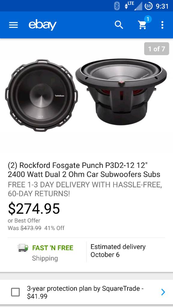

Because this could be a good deal if I can get them down to 250 or so.
