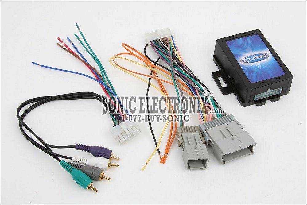

the monsoon amp is likely MUCH better than the amp in the Sony HU. you are feeding the Axxess a signal through the RCA plugs on the Sony HU, correct?
The harness is just being fed by the 4 speaker outputs on the head unit. There's no RCA input on it. Only the sub amp if being fed from the RCA jacks from the back of the amp.
You need those plugs. You need to feed it a low level signal. Simply inserting a LOC in place is a simple test. Or even wiring the RCA outputs to the speaker inputs could do the trick, provided the input impedance is 10k ohms or so.
The older models used speaker level inputs. Newer models seem to use low level inputs
I don't have a LOC but you're suggesting if I wire the RCA outputs from the Sony HU to the speaker inputs on the amp it MIGHT help?
It would achieve you goal of making the music volume match sub volume.
Or use the correct GMOS-4
How so though? The head unit is still going to be putting out the same amount of power to the amp, it's just a alternative way of getting it there.
How are there two different GMOS-4s? The box says GMOS-4 on it and I installed it and it works. I really don't like the amp though, I just wish it could be adjusted and it seems like it'd be kind of hard to remove.

The RCA outputs are low level. Less than a volt most of the time.
The speaker outputs are high level. Several volts or tens.
Power is voltage squared. Substantial difference.
You need to give the factory amp a much lower signal voltage to achieve your goals.
I'll have to give that a try this weekend. Could I just strip the + and - speaker wires, twist them together and attach and RCA plug to them to attach to the head unit?
