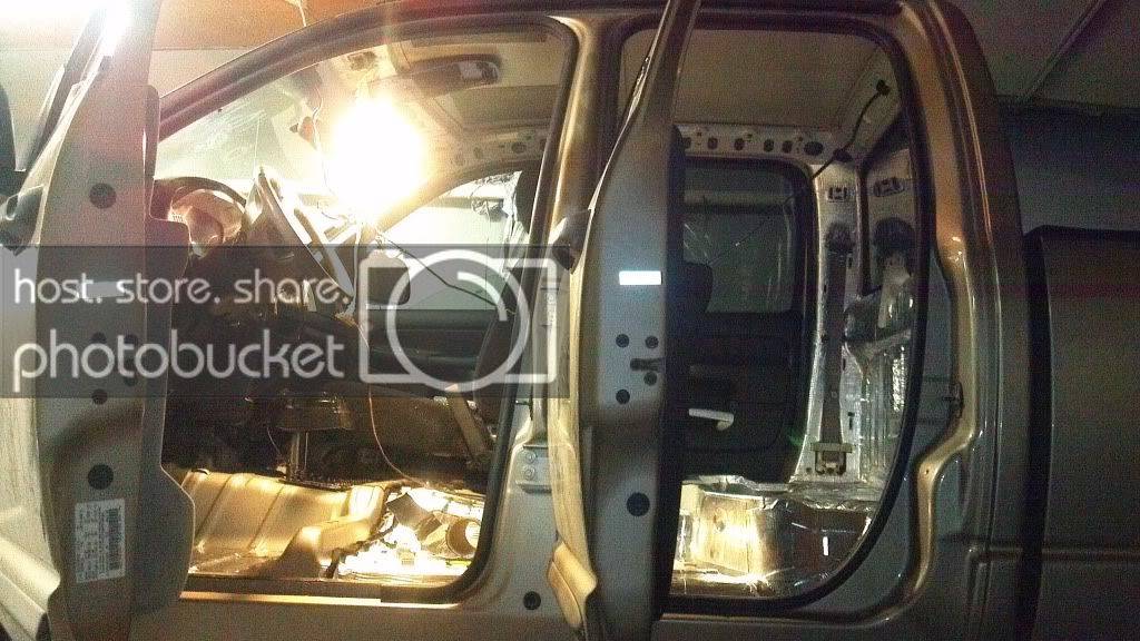

Also, back to what I started with, you said 3 layers of deadener... you've already bought it yes? If you haven't already installed it, I'd return 2.5 of it.
Either you are familiar with the 25% coverage method and you're in complete denial of it... or you aren't familiar with it. In the case of the latter, I'll refer you here: Sound Deadener Showdown - Your Source for Sound Deadening Products and Information
In short, 25% coverage of flat panels, yields the best results, when complemented with CCF and MLV. You could return most of the deadener you got, and get an adequate amount of MLV and CCF and have MUCH better results.
Just something the think about. Do it once, do it right, ya know?
Also, back to what I started with, you said 3 layers of deadener... you've already bought it yes? If you haven't already installed it, I'd return 2.5 of it.Either you are familiar with the 25% coverage method and you're in complete denial of it... or you aren't familiar with it. In the case of the latter, I'll refer you here: Sound Deadener Showdown - Your Source for Sound Deadening Products and Information
Well chit....
Lol yea....at least no one can say I don't have 'enough' CLD.....haha fml
And I can say things like "my dampener cost more than your whole system buddy."
Lmao....even tho its not funny...oh well.....putting in the ccf and mlv tommorow
