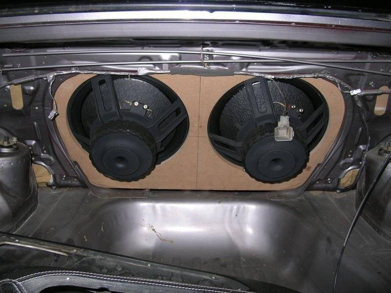

I will include pictures to show my dilemma.
Trunk opening:
Back seat into trunk:
As you can see the available trunk space is ample, the ability to insert the box into the trunk is LIMITED.
IS THERE SOMETHING THAT I CAN DO?
again for DUAL Mojo 15's

The rear seat opening is 15 tall in the center and slopes off to 14 then slopes again cutting our square corners.
THE trunk opening is 16 if i remove all the surrounding castings and such.
But it too has slopes and dips down to 15 on either side and further decreases usable entry space becasue of corner rounding.
ITS VERY FRUSTRATING.
ALso I don't have this dual box setup any more.
the opening is funny, it will permit boxes that are 30 wide IF the box is also shorter than 16 tall.
The trunk will allow 31 if the box is less than 15.5 tall.
the tunk will allow 34 inches is the box is less than 14 tall.
these variances are all attributed to THE CURVATURE of the trunk opening and the NON 90 degree angles are REALLY TRICKY!!!!
Also the trunk will allow upto 20.5 inches depth if the box is 16 tall
The trunk will allow a box that is 32 deep if the box is LESS than 15.5 tall.
