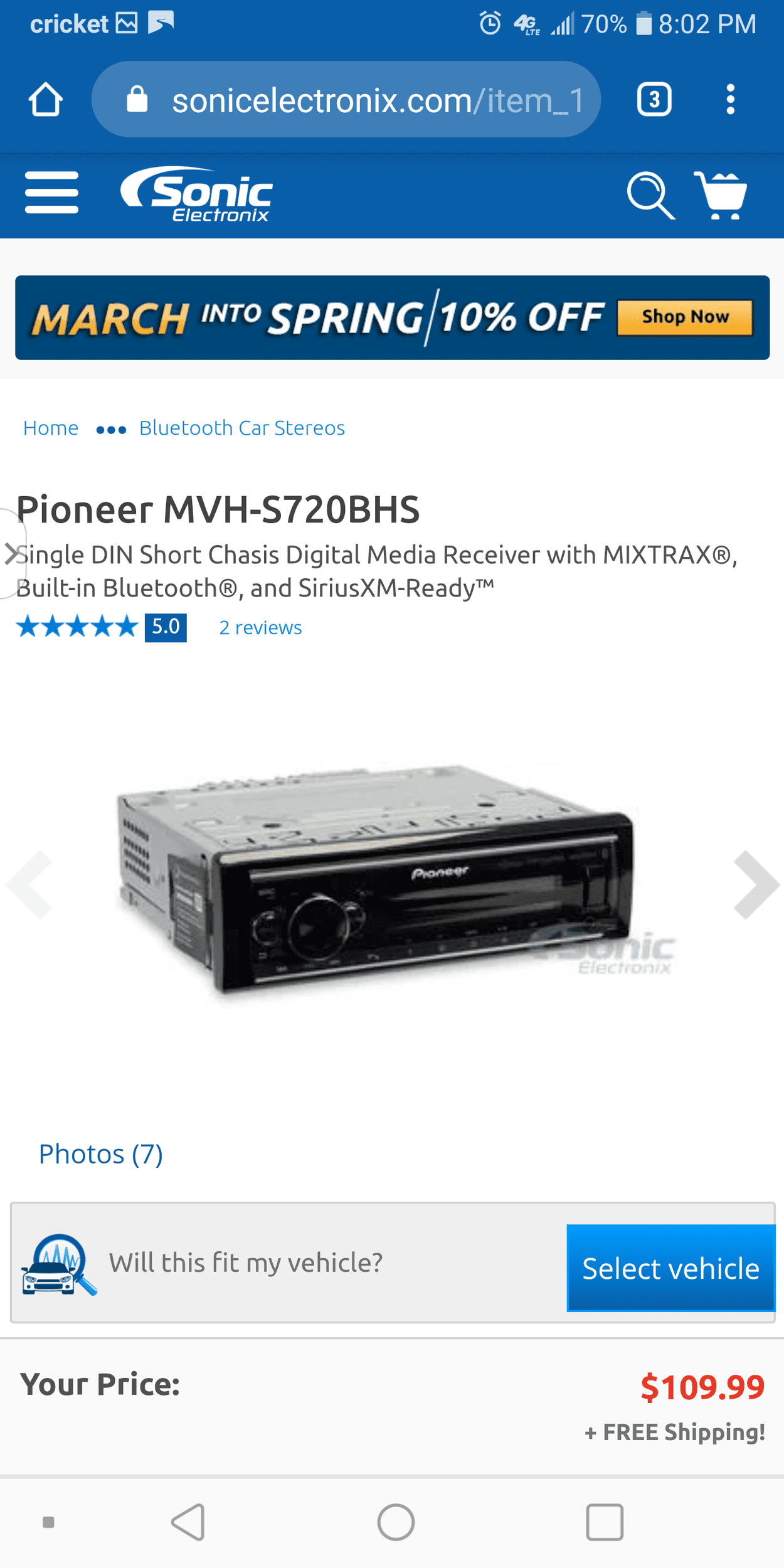

So, im pretty sure im gonna go with that last Pioneer HU.

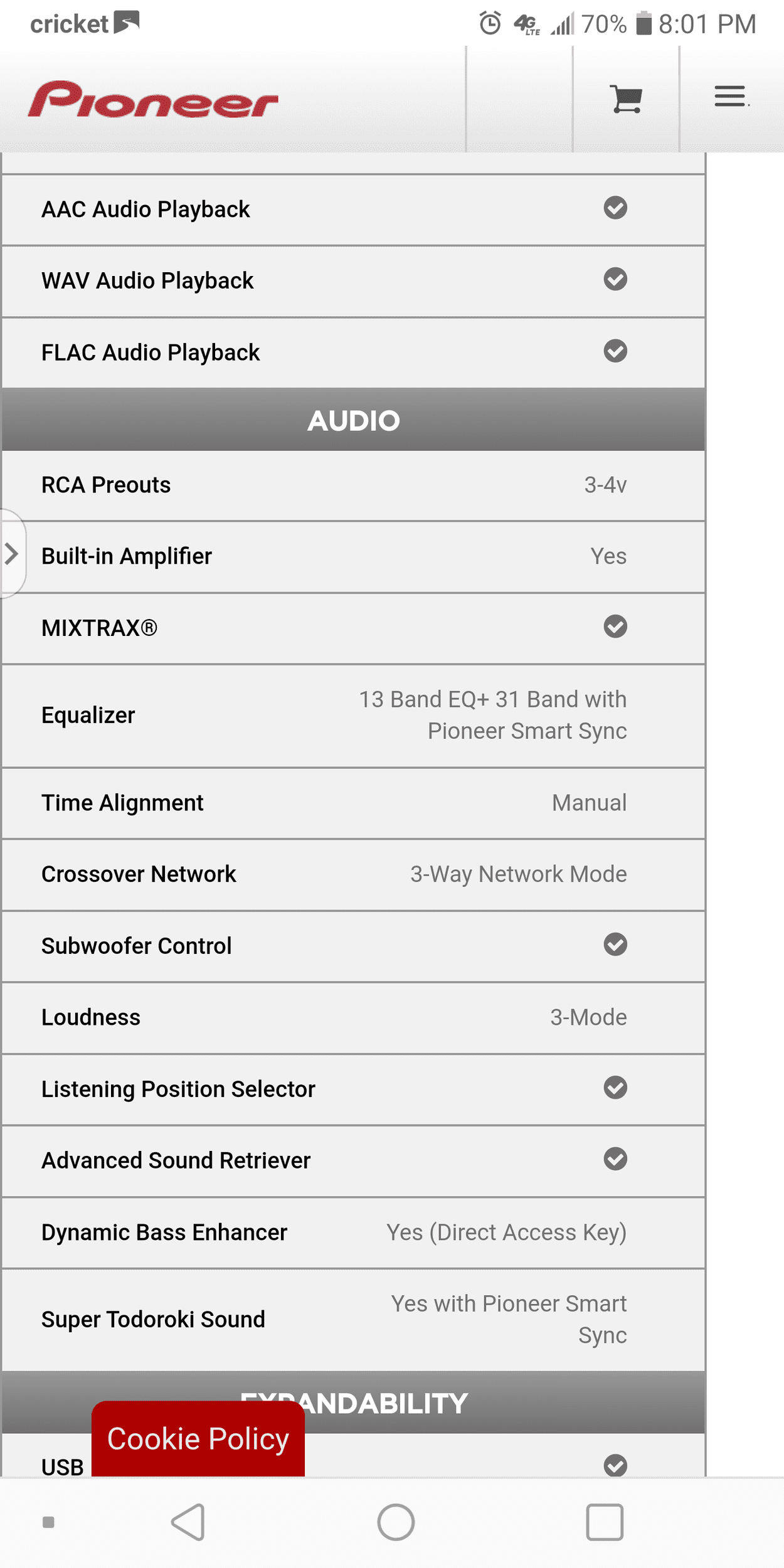

Here ya go, has the 3 way networking mode like 80 prs, (lpf for sub, band pass for mids { lpf &hpf} and hpf for tweets) and 3 sets 4 volt preouts. And fits your budget. Also has 24bit DAC
