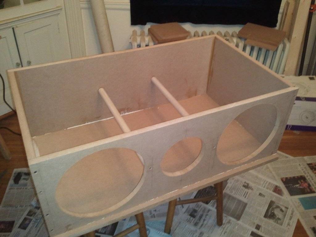

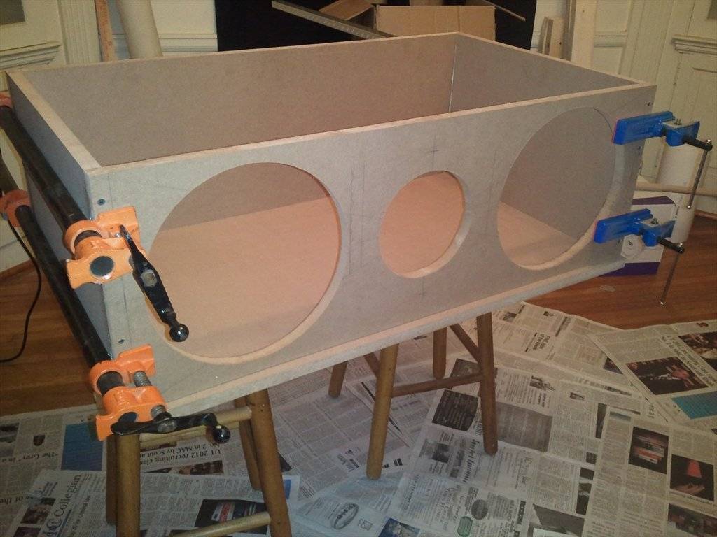

Here is the wood laid out so far
Also this is my first build involving 45 pieces in the corners, wow they are a pita to cut, but not as hard as I thought.

Well finals and graduation are over and I got my building room back after a near week long party clean up from the grad party. Beginning to make some progress. The goal is to have the box done by next weekend to make it to one of the local (2 1/2hr drive) MECA shows. I'm about to order some edead to help the trunk out a little bit.

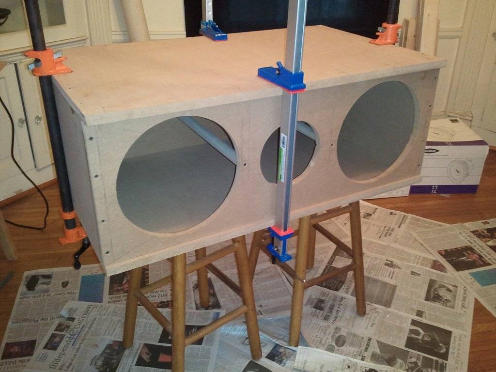

Got this done last night
I'm about to put the bottom on and glue in the 45s and cut the holes for the port mounting lips.
I sat looking at the box for a solid 5 minutes trying to figure out what that extra piece might be still have no clue. I might make it out to that meca event. Also how easy is it to swap ports out and back in?
