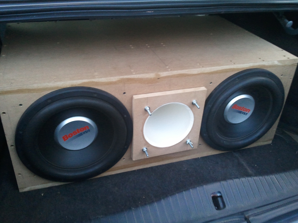

New daily box for some Boston G5's

Box is 4 cu/ft tuned to 31.75hz
The car seems to have 2 peaks, ~37hz and ~50hz, the higher one yields a slightly higher score
fwiw the electrical system is 100% stock and the car has maybe 10sq/ft of deadening between all 4 doors, some may chastise for this but I don't plan on having the car much longer so I don't really see any further upgrades.

Its not getting as low as I was hoping with the low tune, so I think in the next few days I will throw together some more port tunes and see if I can bump the scores up.
