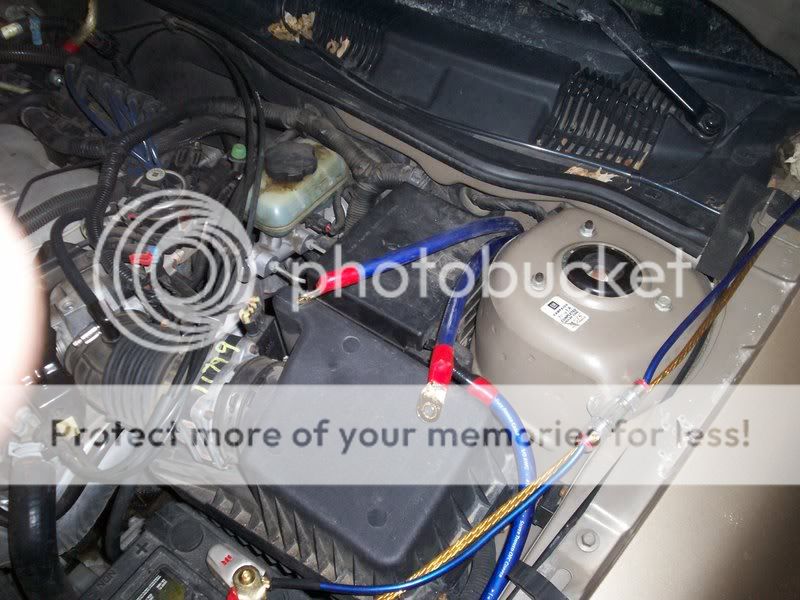

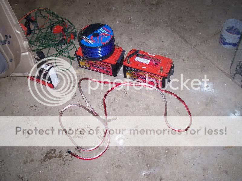

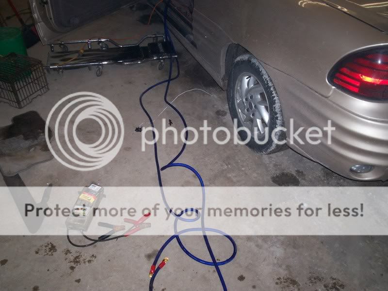

The fine result will the 3 L7 10s in a ~4.5 cuft box tuned to 40 hz. They will be powered by a zx 2500.1. I am running two runs of 1/0 cable from the battery up front to the two stinger sp1700 batteries in the trunk. When I recieve my income tax return I will be purchasing my 200 amp alternator, not sure of the company yet. I ordered an AudioControl Epic 160 which should be here this week.
I was only able to get the power cable ran today, the rest will be tomorrow, which I will update this thread with pics!!

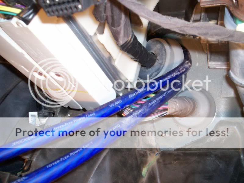

im cutting the gromit tomorrow so the gromit will fit around the power cord, then putting sealant around it, that way it will technically be in the gromit, but i will just be cutting a hole and putting it around the wire. just didn't have time to do that today. had to leave my friends garage so he could sleep.

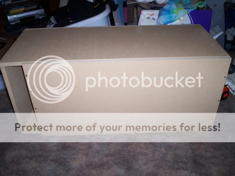

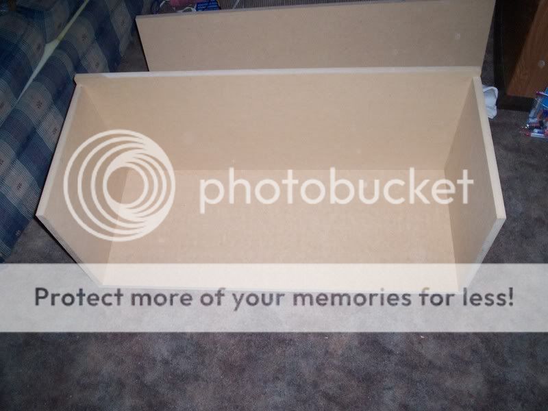

box is almost done, not going to be getting it in the trunk though, unfortunatly, the 40 degree weather never arrived today and it started raining. at least the box will be done soon though.
PICS WITHIN THE HOUR!!!!
