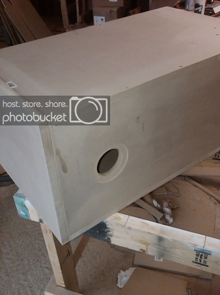

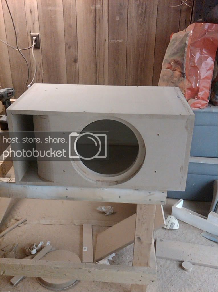

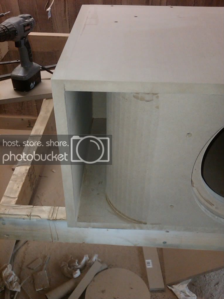

Not really a build log but some pics of the almost finished 2nd box for nineball...had to build a new one because i totally forgot he wanted a flared port. Buyer gets what he wants so i built a new one.
About 2.4 net at 35 htz. Triple front baffle with flush mount...Type X has 1.1875" thick front face so a deep flush mount. Waiting on UPS to bring me moar charcoal carpet.
