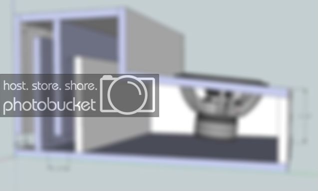

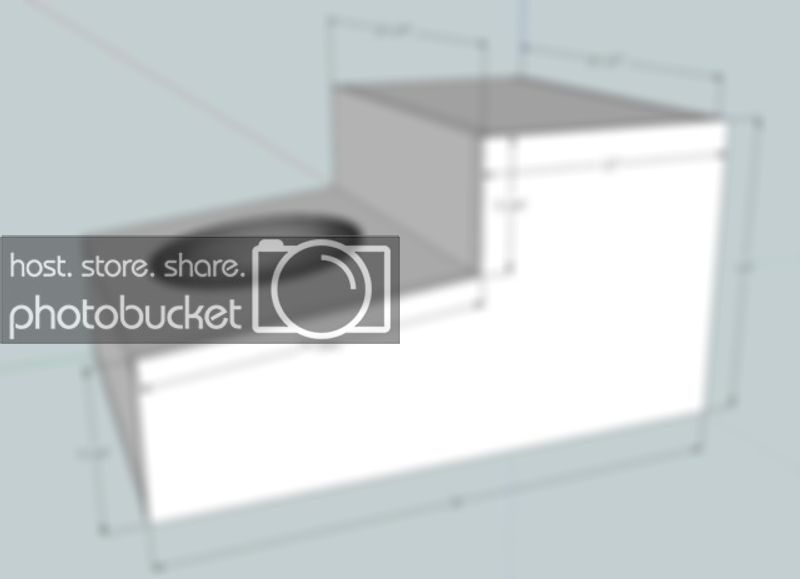

Hey guys, Take a look at this for me would ya? I am getting ready to build this for my wife's Titan, it sits under the driver side 1/3 bench rear seat and when the seat is in the riding position the sub is covered by the seat bottom, just so you can visualize the install. I would like to know if I have the port length right. It is in my calculation, 36" long and the tuning is about 35Hz with a Net volume after port displacement of 1.402CF. This should leave me with a nice size for a good 10" sub don't you think? I am only going to run about 400 Watts RMS because that's all I have for an amp right now, but it should sound nice. Let me know what you think of the design as I might start the build tomorrow.
Can't really check anything without knowing the other dimensions of the box. I'm weary as to how skinny that port is. Seems like it's 1.5" wide, so 10" is probably as tall as I'd go with something like that...but it might work out fine, I don't know. As far as 1.4ft^3 tuned to 35hz, that's good for most 10"ers. Without knowing how tall the port is, I can't tell if it's tuned right. But knowing that it's 1.5" wide and 36" long, and with 1.4ft^3 and a 35hz tune...the port should be about 17" tall, which I figure it isn't, since that is very skinny for a port.
