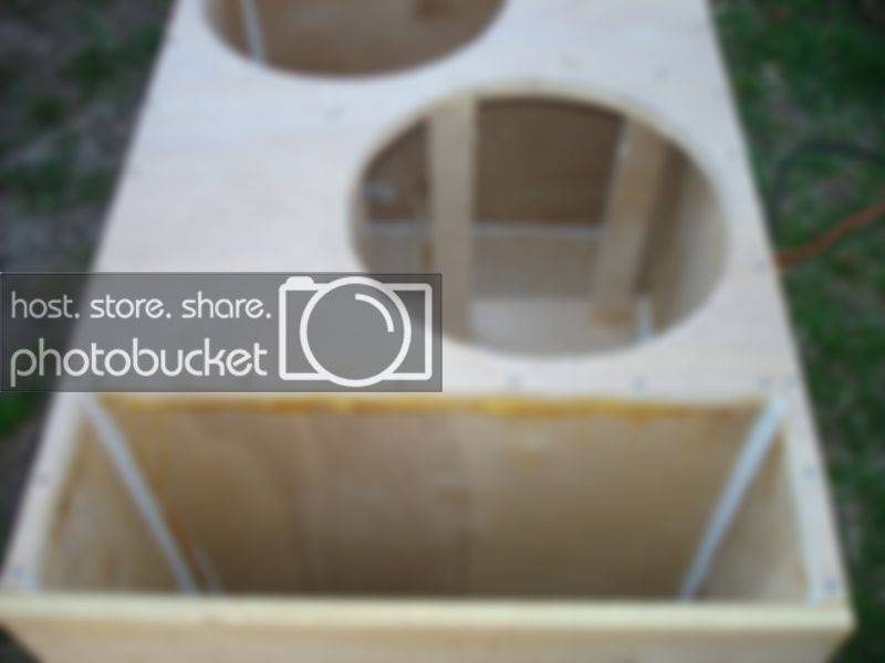

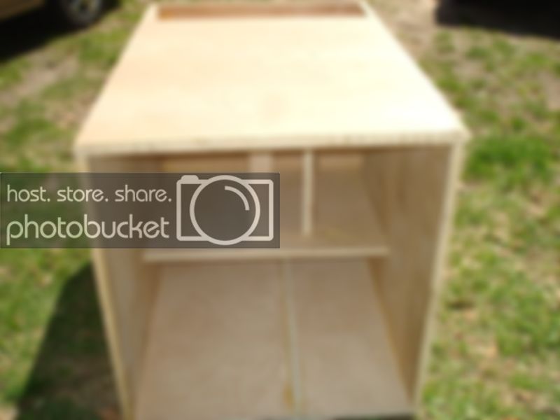

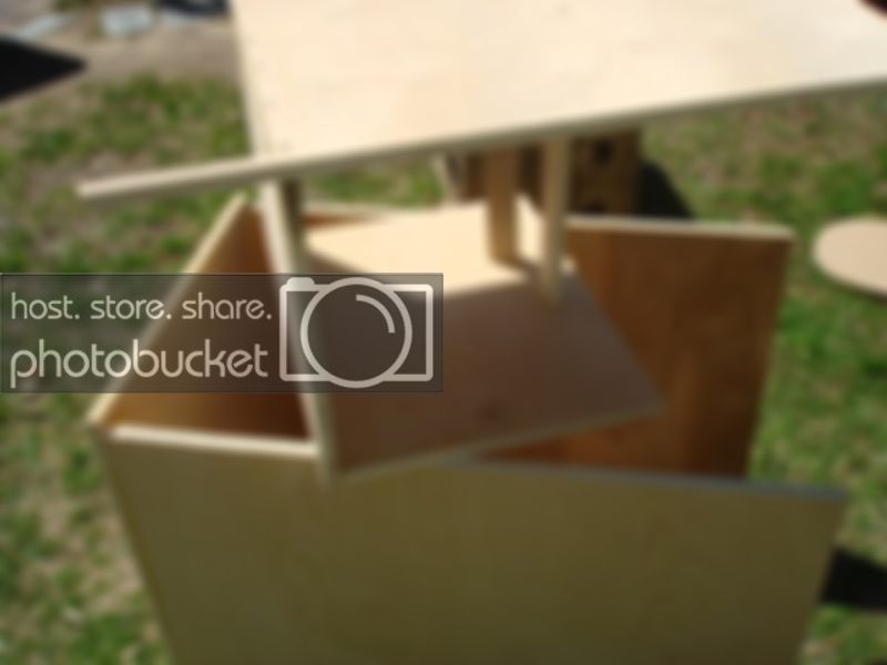

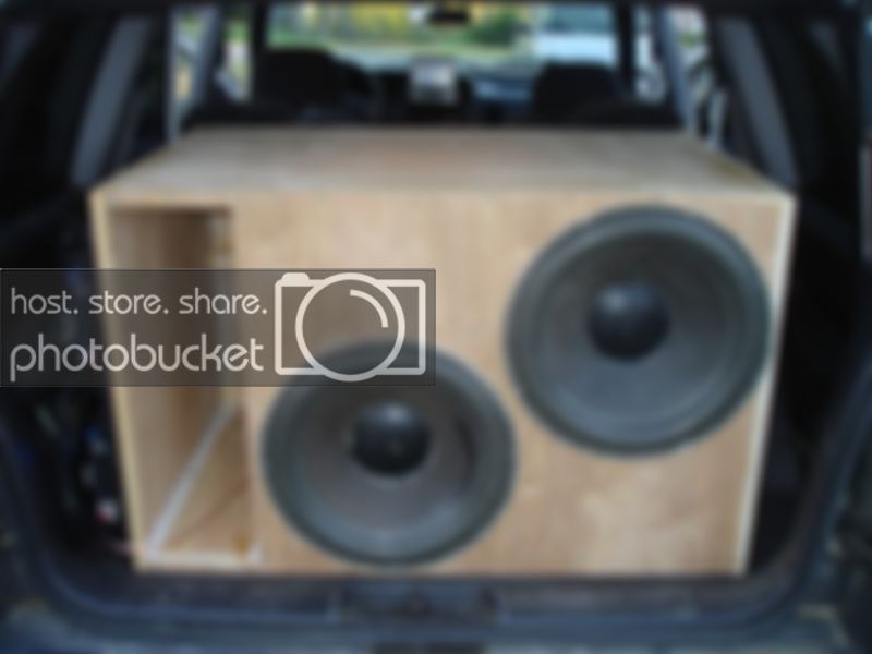

8 cube net, port is 22.5 X 7" tuned to 33hz. It's really loud and actually sounds pretty good with sub level turned way way down. In retrospect I think I will rebuild below the window line tuned to 40-45ish.... May even pay to have one built for a single one for competing. Been super busy with work since I blew off a day to build this fella but I'll meter when I have time and may or may not even finish this box.
If I decide to keep this as/is I'll double baffle. Might also throw another piece of 3/4 over the baffle and throw a single 18 in this. Might be a better box for that and I can keep the shockers for just fartbox.
apparently you missed it when everybody was saying subs up, port back //content.invisioncic.com/y282845/emoticons/wink.gif.608e3ea05f1a9f98611af0861652f8fb.gif
looks good though, im sure its loud.
Yeah, but they weren't both going to fit on top with the port width what it is AND this allows me a little bit of storage space on top of the box.
I've decided I'll either buy or build a separate SPL box since I know these have way more output in the 50hz range, but I find a box tuned to even 40 awful to listen to.

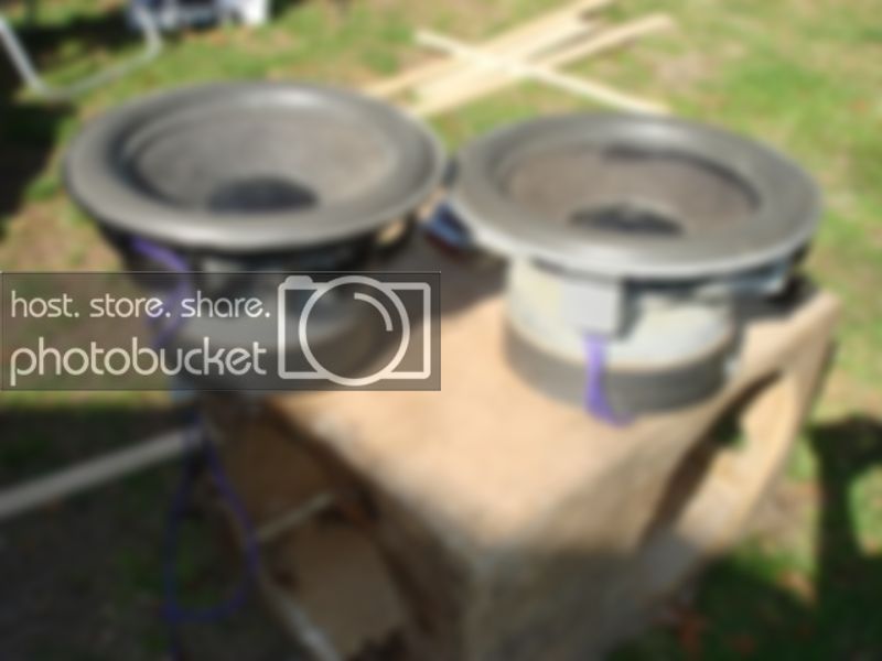

Mounting those subs sideways, you should have added some motor support. Ive seen those 12 spoke frames break with smaller motors than sigs.
Good thinking. Might have to try sub + port up then. I may have time to meter today but I have a huge day tomorrow and sun/mon/tue are looking really busy too. Honestly at this point it wouldn't break my heart to have to rebuild one so both match, but I'd rather do it when I plan to rather than just at random.
I really screwed the pooch with this box in retrospect, LOL. Just metered and still holding 146.6.... on the bright side I can do 146 and change from 38hz to 55ish.... Sounds nice and linear LOL. I guess I'll have to do a shit ton more surface area or do a one-note-wonder to hit 150 //content.invisioncic.com/y282845/emoticons/frown.gif.a3531fa0534503350665a1e957861287.gif
