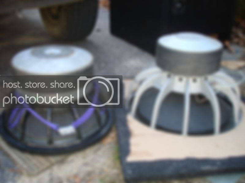

Got me a pair of 15" Shocker Sigs, a pair of SAZ3Kd's and a couple sheets of MDF. Their home will be Jeep Grand Cherokee. Got alt and bats to back this up.
I'm thinking 7 or 8 cube with 160 square of port tuned to 35 port and subs facing either up or rear...still haven't decided. IF this won't break 150 how high should I tune?
