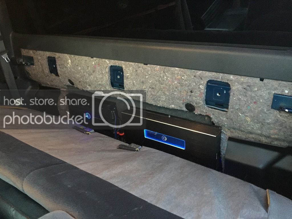

Gotta build a new amp board and I'm needing some ideas on how to hide the wires. Should I router out some grooves in the back of the board for the wiring or should I just make a cover board with amp cutouts? I'm open to other ideas also, these 2 are just the first ones to enter my mind.
i am moving away from hiding wires under the board with holes through the board. it can look nice and i've done it for almost 20 years, but servicing and changing is a PITA. moving forward, i'm running wiring on the surface (neatly, with zip tie mounts) and then building a beauty panel that has cutouts. this looks nicer and is easier to service.
