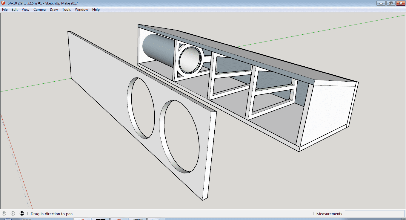

Just askin'... whats your space available?.. it's a 2" lift?.. 54" wide at least?
Think 2 Sa-10's would be enough?.. it's 2.9ft3 net around 33hz
I do have a seat lift and thats pretty much the same box I have except I made mine a little smaller for the sa-8's. As far as the 10's go thats kind of what im going back and forth about cone area wise its about the equivalent of 3 8's so I am debating on if that gain is worth building a bigger box and buying two more subs.
