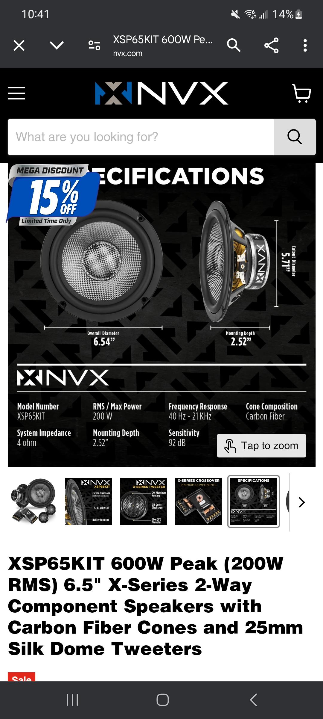

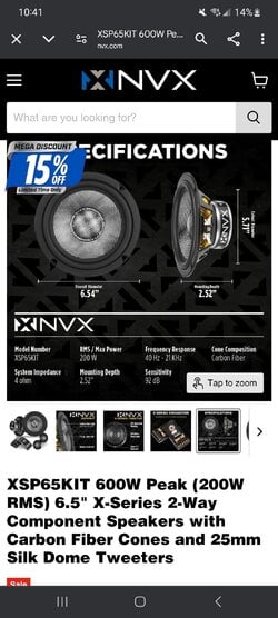

NVX X series 6.5 components ($140)

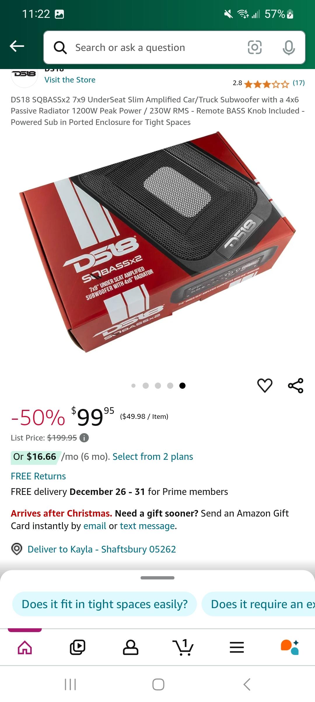

DS18 240w RMS powered sub ($100)

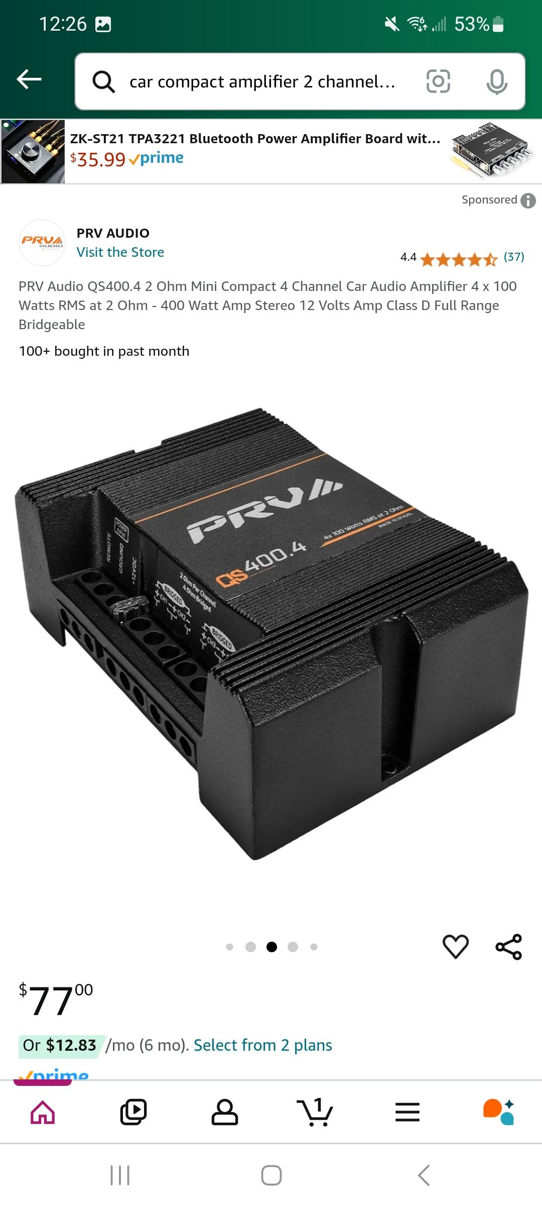

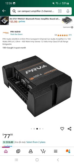

PRV QS400.4 it's 2 Ohm stable 4 ch but you can bridge it to 4 Ohm 2 ch. Couldn't find a dyno but people seemed happy with it. ($80)

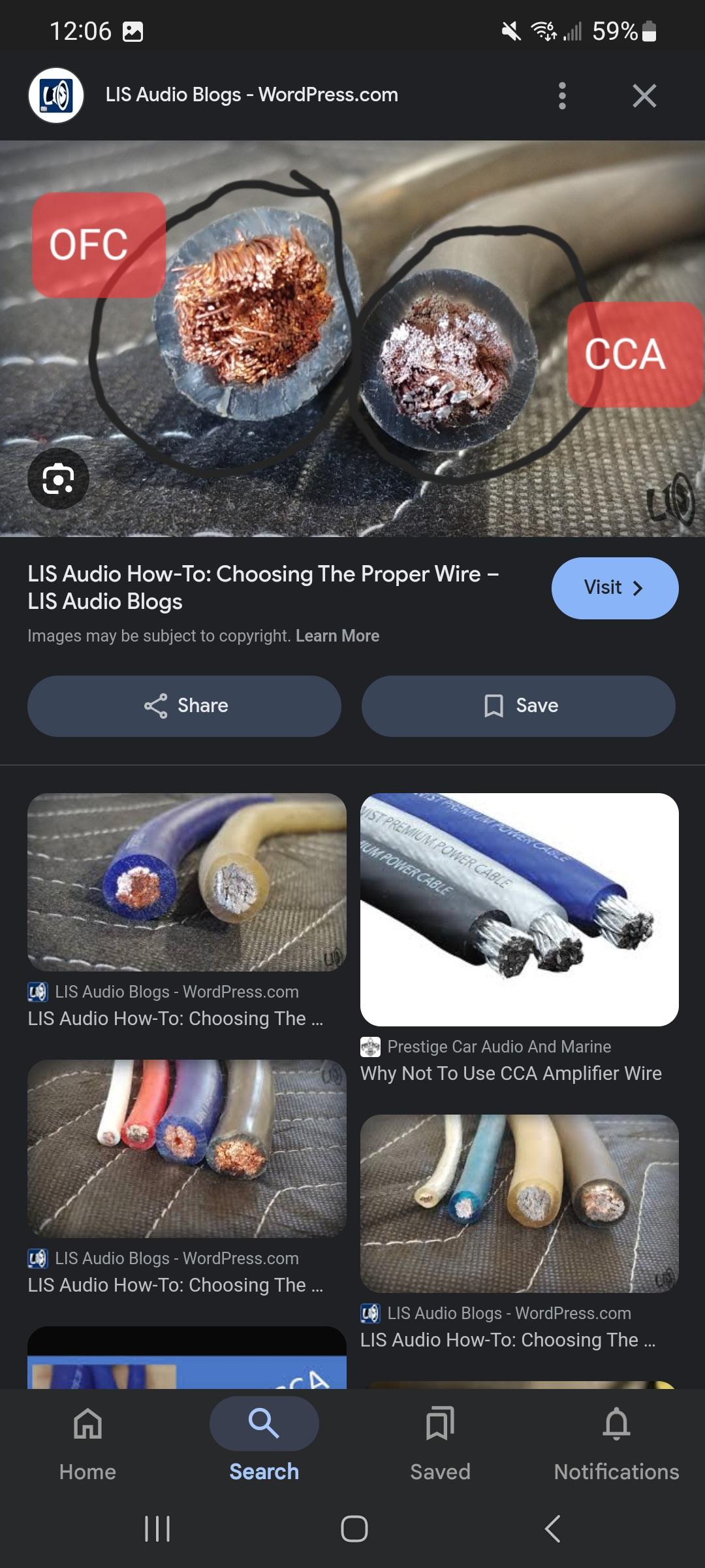

If you use an install kit with CCA cable (look at the end of the wires, silver color mixed in with the copper) size up. You'll still only be looking at probably 8g even with CCA. You're not looking to maximize your efficiency, just to get the power you need.
