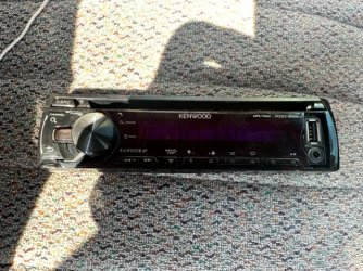

Current setup:
Older Kenwood Unit

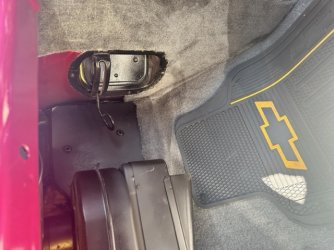

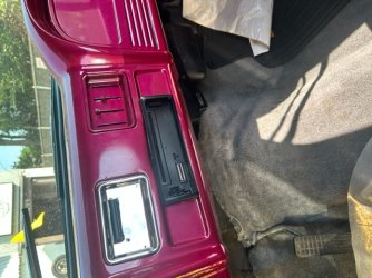

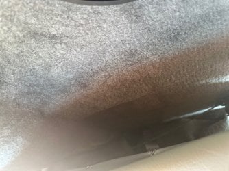

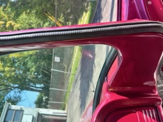

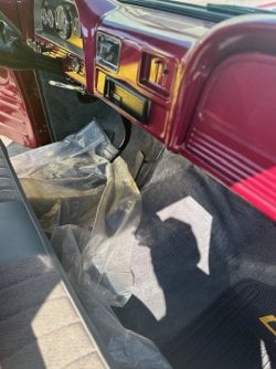

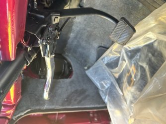

I have attached some photos of the interior. It has a lot of metal hard to find places for speakers. (Need ideas!)
My budget is around $500-$1500 (Crutchfield products?)
I’m looking to get a decent head unit and figure out how to add additional speakers (currently only 1 speaker is allowed) want to add at least 4 speakers) and how to make it sound great.
I was assuming maybe something like external 4- or 6-inch speaker kick panels? somewhere or maybe something under the seat?

the dash and old head unit
old unit
Corners possible external kick panels?
Corners of the upper dash has lots of metal hard to attach anything

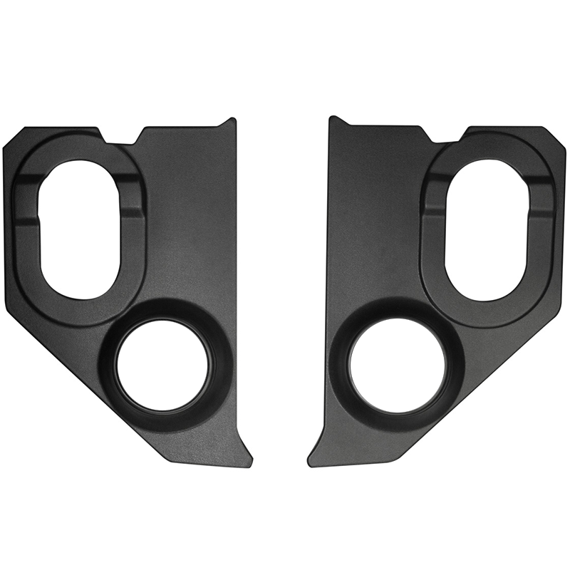

The Current external kick panels only one design exist with cut outs for the flappers
Underneath the seat will allow for some room for speakers, subwoofer? and amp?
Dash area

The doors are metal and cant and would not want to really do that they are panted sorry cant really see that in the photos so I can not run anything to the door really they are metal and painted
Put 6.5 mid range speakers in the kick panels, surface mount a set of tweeters to the kick panels and do a couple of low profile subs under the seats. These trucks are loud inside, I would most likely go with pro audio 6.5’s over a regular coaxial or component set, because you will want the extra volume that they can produce. Your biggest problem is going to be getting enough bass to keep up with the rest of the sound. If you ever decide to get the gas tank out of the cab, ( I highly recommend that, regardless of the speaker situation ) the you will have the room to do a much better subwoofer setup.

The head unit is not bad, but it might be missing some features. I like Kenwood Excelon head units. They are easy to use, and have some decent adjustability. You can get with or without CD player, USB front, and have 5v preouts. $100-$150
The first thing I would do is figure out placement. I think this is what is limiting you if you aren't willing to cut. Search for some premade body panels for the speakers. Thats a popular body style to customize, and you might be able to find some nice ready made pillars or door panels. You should really see what your options are for where you can mount em. If you're up for it, you can always make your own fiberglass panels. You really want to get your tweeters up near shoulder/head level to hear em. You can buy generic tweeter pods and mount them to the dash, pillars or even the door, but you need tweeters, and you need em higher than the kick panels. Unlike everyone else, I think your biggest issue right now, is where are the speakers going to go. If you had to spend half your budget on panels so they are up in the right location, it might be worth it.
Two ways for the front are cheaper, but are going to be nearly impossible to find a good spot if you're not willing to cut the metal. You're ONLY option would be to get some components. Mount the 5.25 or 6.5" mids down by the kick panels and get some tweeters mounted up higher. On the dash, the door panels, even the roof with your steel body.

Your alpine head unit has a 3 band eq, that's a real turn-off for me.

Head unit, add $20-$40 and find something with better features.
