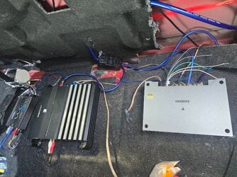

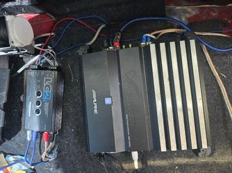

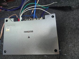

I've got a 2023 Ram 5500 cab and Chassis and it's got the Factory six speaker 8.4 in Uconnect 5 screen all Factory.. I've added an Alpine 450 mono amp powering a 12-in audiopipe. I've replaced the front door speakers with nvx 6.5 in component speakers with tweeters... I've got the LC2i being connected to the left and right rear door speakers to get the low input to power the subwoofer. Powering my front two door speakers is the Kenwood kac-314.. I'm getting horrible feedback from the subwoofer pulsating sounds sometimes long humming sounds how can I stop this... I posted a Pic of the set up, it's not fully done so excuse the bad wiring I forgot to mention that I had to use an aftermarket base knob so the RCA runs from the lc2 up to the base knob and then back to the amp and I've got that done twice one for the doors for the highs and meds and then for the sub

Question; why does the LC2i have blue RCAs on the bass output, but red & white RCAs into the Alpine amp?
I would also clip or tape those input wires on the Kenwood. They could cause issues if grounded.
They're just two different RCA wire brands that I grabbed and I took those input wires off
Does the Kenwood have output RCAs. If yes, plug the Alpine to those and see if the sound persists. If it does, disconnect from the Kenwood and connect your phone to it via 3.5mm to RCA cable.
The Kenwood only has a and b inputs for each Channel it's a 4-channel amp
