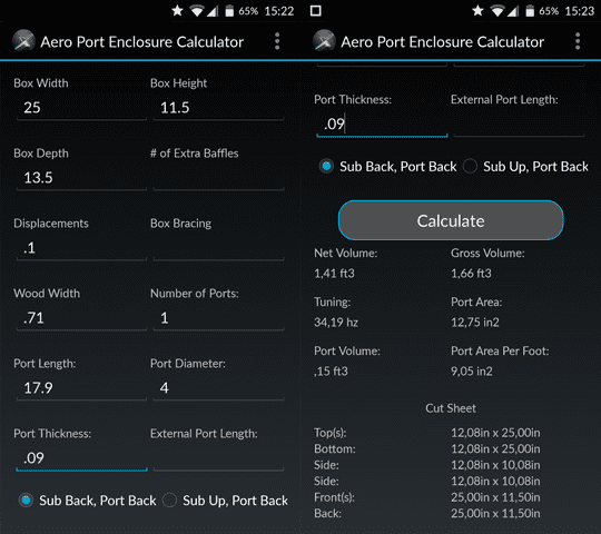

@Jeffdachef @papermaker I found one on accident this morning, 4" diameter and 17.9" long.
What do you think?
Try entering these in to torres. For the depth I took the avarage between the 2 different depths to get the same volume as the wedge design that I'd use.

that port should work. thise amps kinda ****..
