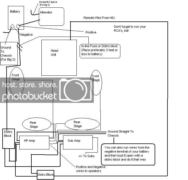

Here's a nice little map.
Incase you need it.
