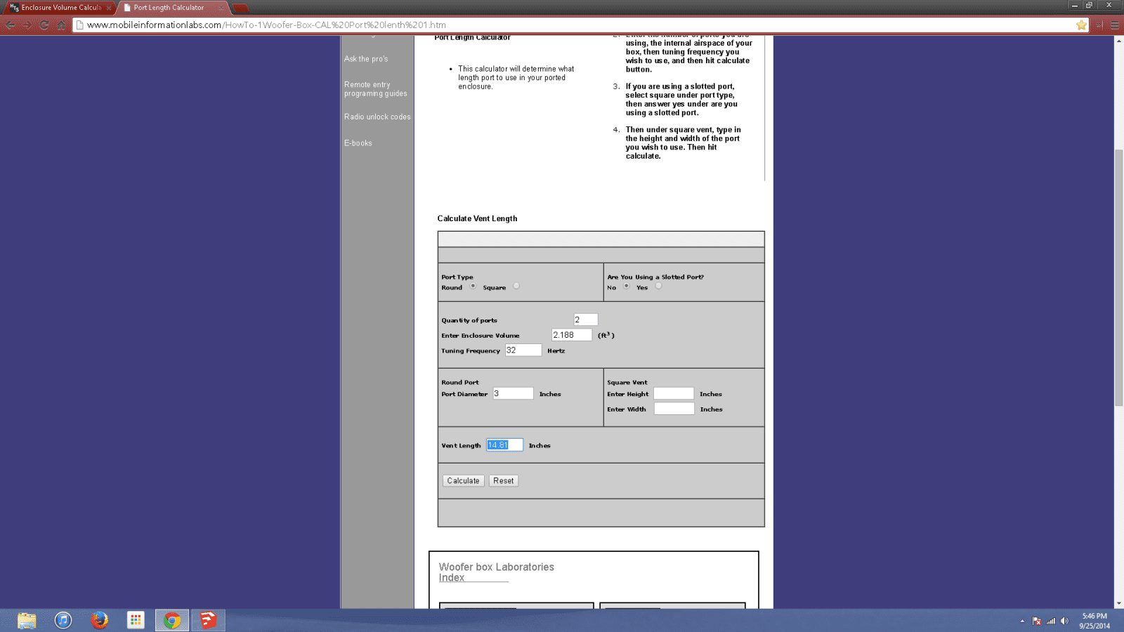

My question is A port calculator website gave me a port length of 14.81 inches
Does this include the 5 1/4 inches that extrude?
Is the 14.81 inches for each port or would each be half of that?

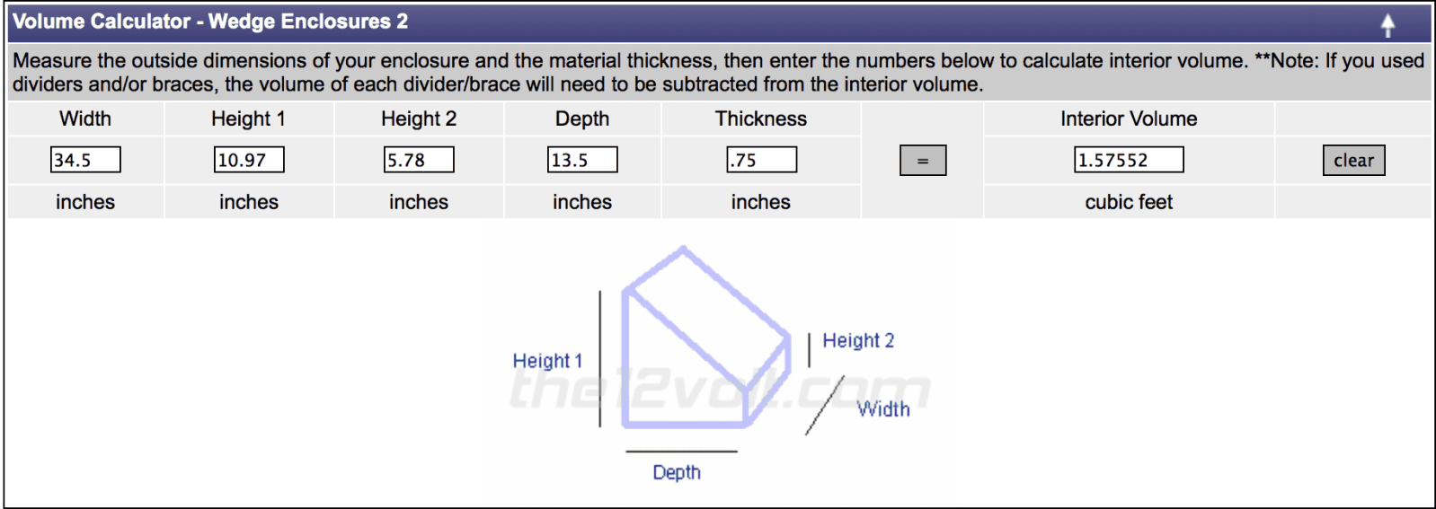

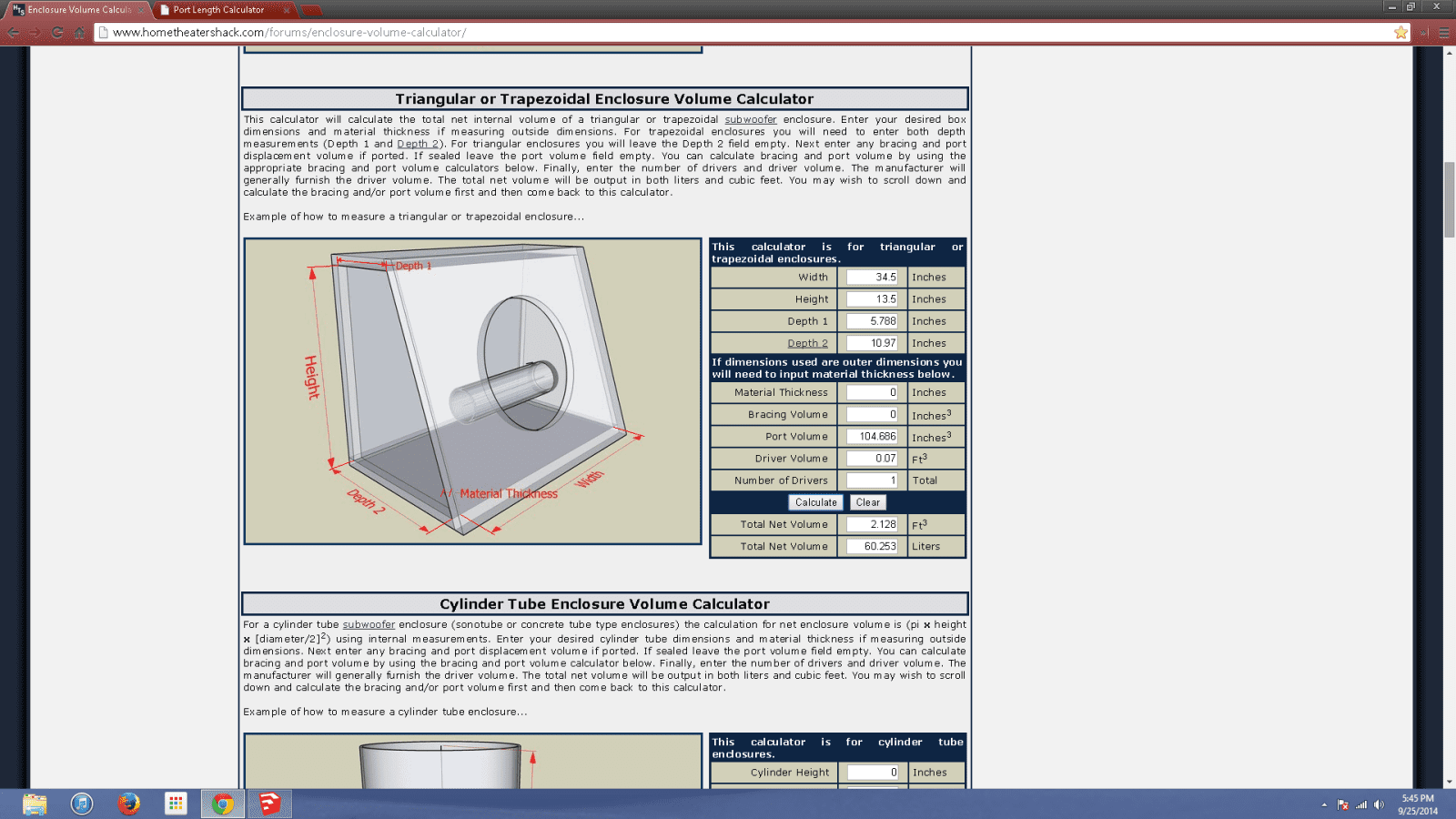

your box is 2.18 gross probably but NET the actual usable air space for the sub is 1.57^3 then you need to account for sub displacement and port displacement... i hope your putting an 8 in this box or pushing the limits of a 10

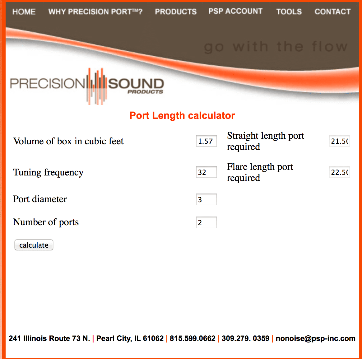

nope none of that was included in your calculations, i used the specs you got on the sheet and this is what i got
your sub is recommended in a ported enclosure 2^3 after port and sub displacement
and i used this for the port length

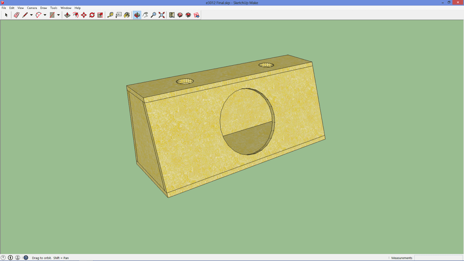

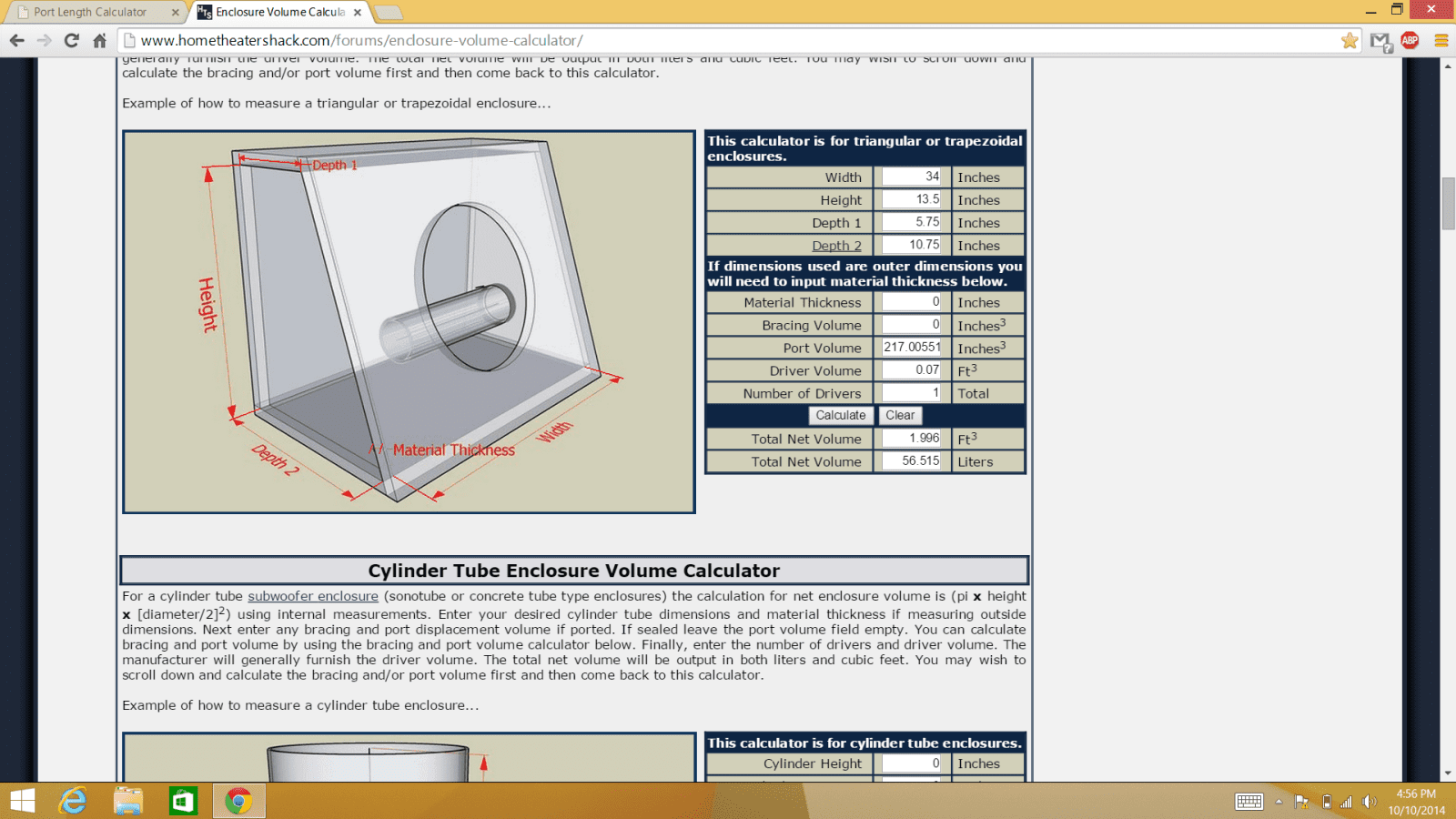

Anyways I have just finished building the box and took actual inside dimensions not calculated ones I'll include in pics
with these measurements I calculated a 15.35 inch port length now.

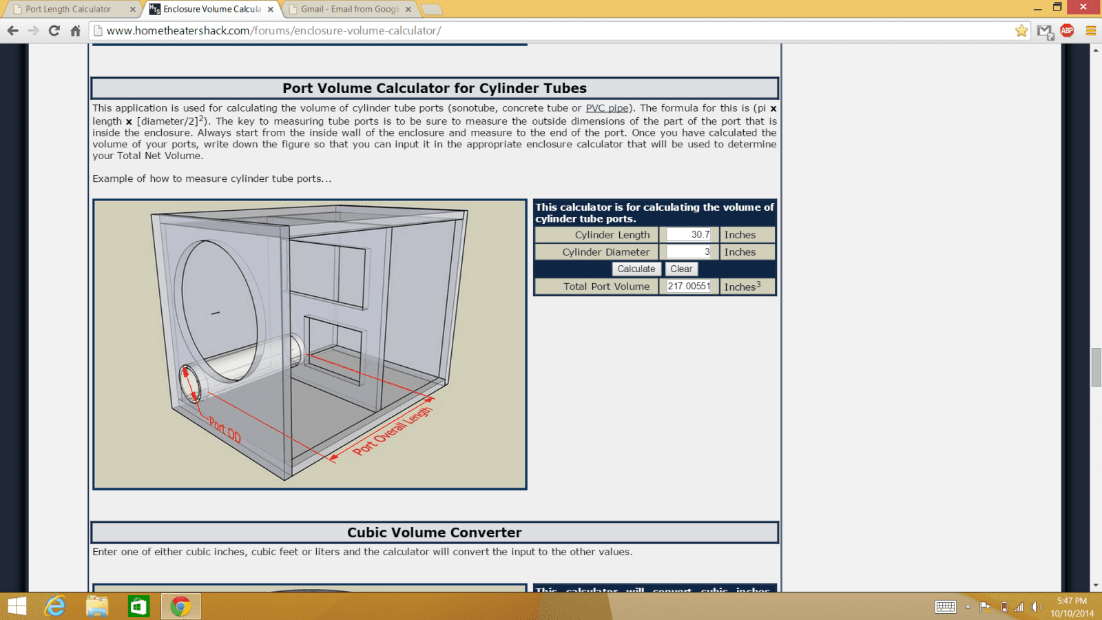

Since I need 2 it's a total length of 30.7 inches and using a port volume calculator I got the volume of the ports to be 217.0051 in^3
I went back and imputed all the data and added .07ft^3 for driver displacement (estimate infinity doesn't give displacement specs)
All together that gives me a volume of 1.996ft^3 which is perfect because infinity recommends 2ft^3
Is my math correct?
