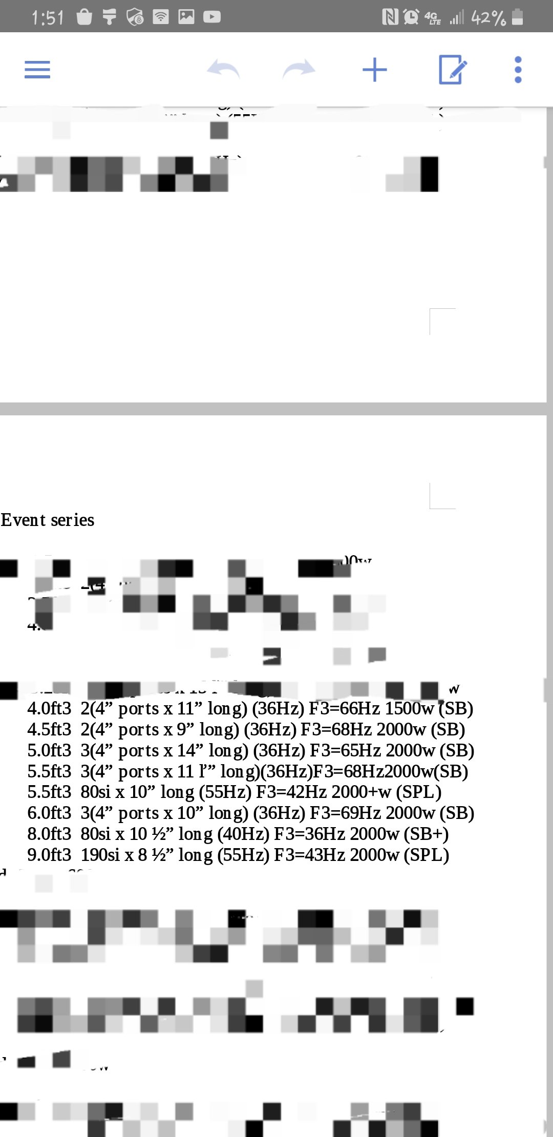

I honestly don't really know much about all this i was just going off what what they sent me. So would it be better to build one of the boxes tuned at 36 or 40hz? Im attaching the different enclosure sizes for my ele 15

You absolutely want to tune to 35-40hz for music. I really enjoy a 4.5-5 cube net box tuned to 36-37. If all you want is loud then sure tune to 45hz+ but no one does that unless they want a peaky high score without the ability to actually somewhat enjoy music.
That sub is a 3 inch coil for **** sake why the hell would they rate it 10k? You want a 4-5k amp to get 2-3k after rise, if your electrical can support it. A box more towards 5 cubes net will need less power.
They're also recommending an ungodly amount of port area. A single 8 inch port from bigassports will give you what you need. Iirc a 5 cube net box with an 8 inch aero port at 35hz is somewhere around 15 inches long.

I have the sundown sfb-3000d pushing it an 3200w 1ohm(dyno tested) i have a 370 amp h.o alternator and the big 3 upgrade and a xs d3400 battery. I thought that was an unreal amount of port myself. But i think im gonna build 2 and see which i like better. Going to build the 8 cube tuned at 40 and a 6 cube tuned to 36
There you go, build both. That's actually a good idea, wood is cheap.
You'll get around 2kw after rise out of that amp unless you clip it. That's the right amount of power for that sub. Might take 500w-1kw more in short burps but not much more than that

Try sizing it for your power and tuning 40hz or under if you want something musical.
Personally tuned mid 30's I'd go 4.5ft3 or so on your power with that sub
