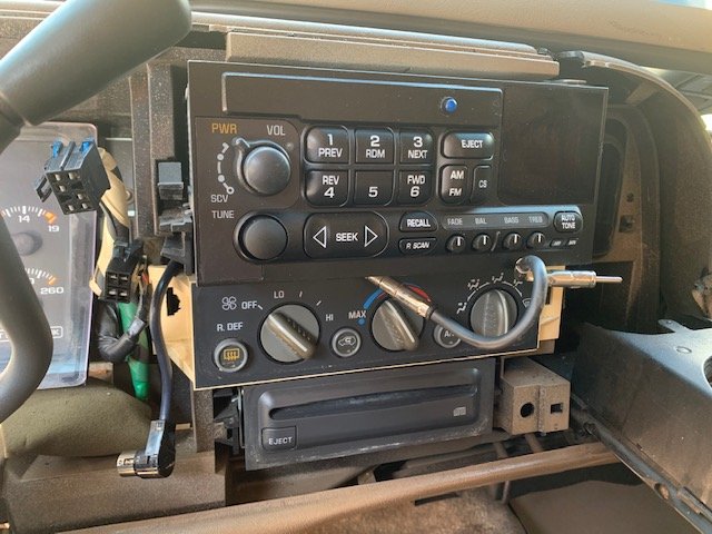

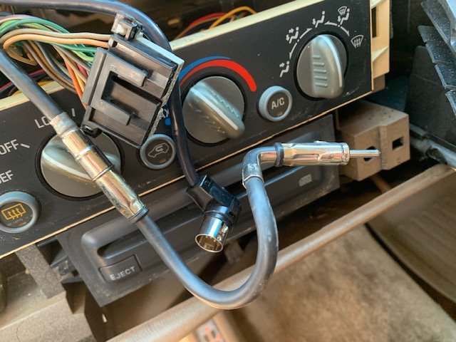

Good afternoon, I'm new to the forum and changing the radio out myself, don't want to pay someone to do it this time. I've reverted back to my 16 year old self and bought a ‘95 2 door Tahoe with an after market radio and am going back to the factory radio but want to be able to add a sub later down the road. I’ve got the factory radio (that has Bluetooth added) and a 4 Chanel line convertor to add. I took the aftermarket radio out and plugged up the factory radio and it has power but no volume.

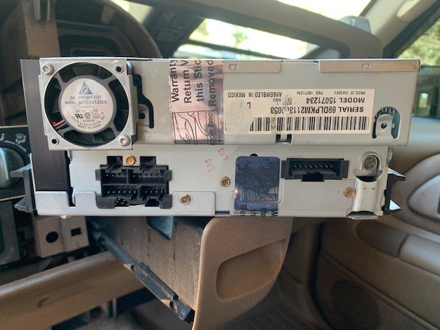

My knowledge is very limited but there is another plug left open in the back of the factory radio as pictured. What needs to go there and what am I missing here?

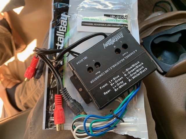

Also, what wires need to be added/changed for me to connect the 4 channel line convertor to add a sub? Also what sub wires do I need to feed up there? Optimally would like to open this all back up once.
Added some pics too.
I'm more than happy to answer any questions that could help lead to a diagnosis. Thanks for any and all advice!

The empty plug may be for an anti-theft system or other features in your vehicle. Check one of the speakers to make sure the previous owner didn't disconnect the speakers and run them from an amplifier?
Look for a wiring diagram online to see which colors are for which speakers. You can do your splice behind the stereo, or run your LOC from a speaker near the location of the new amplifier. Purchase long enough RCA cables to reach from the LOC to the input on the amplifier.
If you still don't get any sound, pull the plug, look for bent pins and reinstall, before looking at the stereo as the culprit.

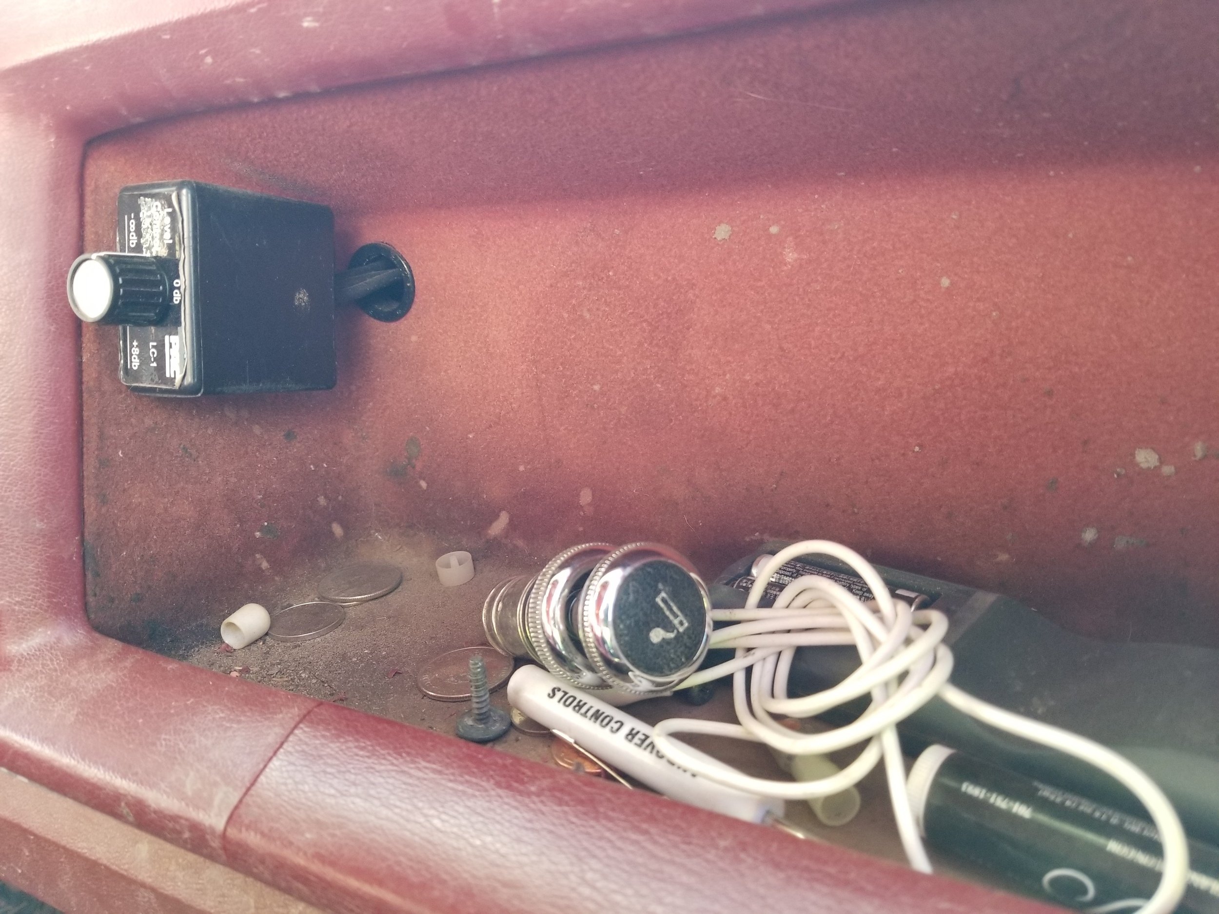

Some amp manufacturers give you the option of a remote gain control that plugs into the amp. These are manufacturer-specific. Another universal option is a potentiometer that goes inline with your rca's. The latter might not be a good option depending where you place your line out converter (I'm assuming you want it within reach while you drive).
I personally prefer the rca potentiometer style because it's one less wire to run in the vehicle, and if you connect your rca's near the deck, the placement makes it easy to find a convenient mounting place for the knob.
How do you use the vehicle? If you're keeping the oem look because you display it, i would look for an amp that offers a remote gain control. Run the wire dirty across the interior, and remove it when your vehicle is on display.

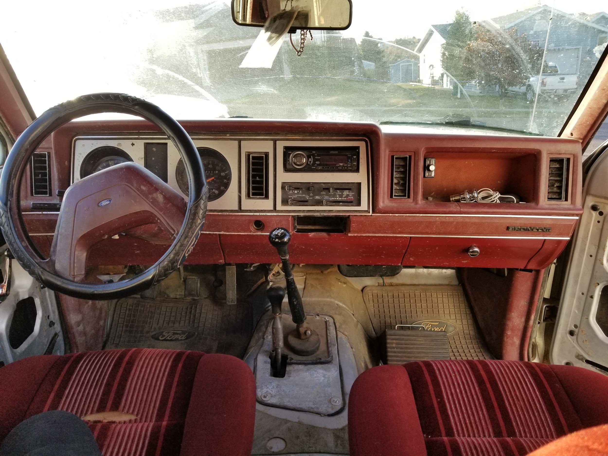

Here's how I mounted my knob in my offroad rig. I'm very happy with it, but as you can see I drilled a hole in the dash console to get my wires through. Not sure how original you plan on keeping the vehicle, and I wouldn't drill noticeable holes in any of my other vehicles. Sounds like a neat vehicle, by the way! Those two-doors are sharp and not very common. I didn't know they stuffed a diesel in them, but that's because I'm a Ford guy.
