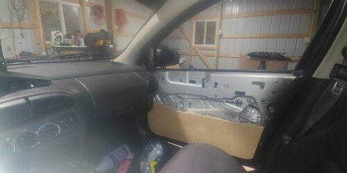

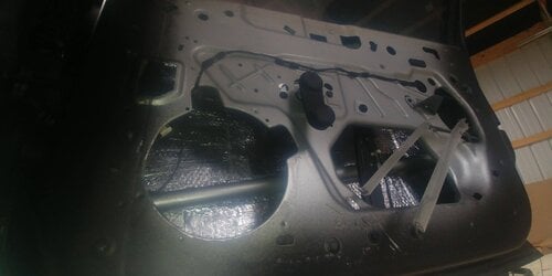

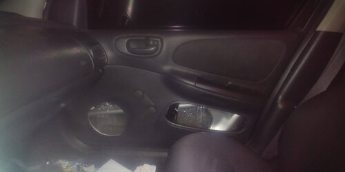

I have an 8 and a 6.5 that I want to put in each of my doors. I like to make this an SQ build as much as possible. I'm under the impression that I will get better mid bass from these drivers if I can seal off my doors and have the speakers firing directly into the door cavity. I'm also under the impression that the best placement for the 8 and 6.5 is right next to each other.
So, my problem is the location of the current holes in my door. The factory speaker location is fine for the 8, after customizing the door panel, but the other hole is further back on the door and will essentially be firing right into the seat. I could possibly custom mount the 6.5 to be angling up so that the majority of the soundwave is going over the seat... but that would just be helpful on passenger side when noone is sitting there. On drivers side, the speaker would still be firing directly into my hip. So is this a big deal? If I were to move the 6.5 next to the 8 then it will not be lined up with the door cavity and I'd be losing out on that performance benefit.
I've been racking my brain like crazy on this and watching a ton of other people's builds. It seems most people just mount their speakers on top of the existing door panel and then glass over it all. But these setups aren't firing into the door cavity... so they're missing out on some performance right?
Any insight is much appreciated. It's my first build. I'm up for the challenge of rebuilding/fiberglassing my doors, I just can't conceptualize where the speaker placement should be. It doesn't help that I have a stupid window crank in there as well...lol.
Here's a couple pics..

If they are both in the door you need to seal off the mid from the midbass completely or else the rear waves will destroy every bit of sound quality. Its better if you just do 6.5s in the kick panel firing up on axis to you. You can use that free space in the door for more midbass if you wish.
Thanks for this. I hadn't thought about the sound waves being problematic to each other if they are both firing into the door cavity. I think it will be a much simpler install to just custom mount the 8 in the factory location and fab the kick panel to house the 6.
Cheers mate!

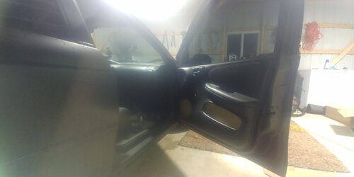

Thing is concerning the 6's, my kick panels are very small, its a Dodge Neon afterall.
So, since it sounds like your saying location isn't such a big deal if you do time alignment, could it be fine to just cut off the end of the center console and fab a little box to house the 6's in the center under the dash?
It's a bad picture but you can get an idea how small the kick area is. On my drivers side, I was looking at it today, I would be kicking the crap out of some pods if I put em there. I don't think kick panels are an option for me.
What do you think?

I meant for the distance between the mid and tweet, they still need to be left and right for soundstage, and stereo seperation, you cant have them in the center like that. Your other option is to trade the 6.5 in for a 4 inch mid and fiberglass A pillars or do a sealed custom door pod for the 6.5s above the 8

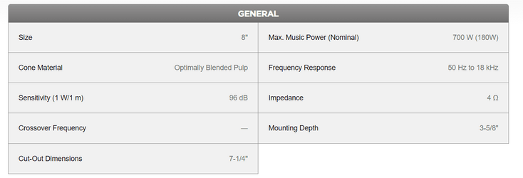

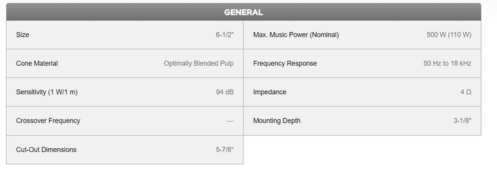

I wanted to post the specs on these 8's and 6's just to make sure I'm not doing something stupid.
We've been talking about the sound wave getting screwed up if the 8's and 6's share the same air space so it made me wonder if I have the wrong speakers to pair with each other since the specs say they operate at the same frequencies.
Is this a null issue as the amp crossovers or the dsp would just be set to make each pair of speakers operate in the desired frequency range?

its the same concept as running multiple sized subs in your car, its going to be a giant mess throwing it all in the door like that. side effects would be extreme lack of midbass, muddied midbass and midrange, horrible instrument seperation aka everything sounds like a gob of noise rather than music, harsh peaks and severe dips and valleys in the frequency response and the list goes on this is with crossovers seperating the frequencies so each are doing their own jobs already and you'll still run into all these issues.
