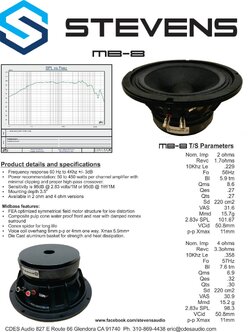

I think I'm going to settle on these Stevens Audio 8s. People are saying some pretty good things about them.
Personally heard them, weak midbass, not special in any way. there are cheaper drivers that sound way better. Overhyped for no real reason. Even a crescendo PWX 8 that was in the setup before had literally at least 5x the midbass output compared to the stevens audio which replaced it. Needless to say he went back to the pwx. however this is a 3 way network mode front stage consisting of midbass, midrange and tweeter and the pwx is not good for midrange performance, very good for midbass though.

What would you recommend for $200 a pair or less? SQ is desirable but would like the potential to get loud and keep up with a high powered sub. Strong hard hitting midbass would be great. They will be firing into a properly sealed and sound treated door.
I just don't have the experience to know whats good. Some guys at SMD forum are who recommended the Steven's. Tbh, I really don't know what to choose.

those look like the midrange series think u need the midbass...
always had my doubts about that driver although it seems to be a forum boner on other forums...they model up in winisd not that impressive...although they do have a fairly low fs/fo or wateva. Even my cheap pair of prv 8mb450v2 model better in winisd but i havent install them yet but ill comment when i try them..im also trying a 3 way set up
yea over at SMD those guys act like theirs nothing that compares to them for under $200 pair.
They also have no idea what sound quality is so anything mediocre clear to them they think its good. Was soo disappointed with the 8s. Soo much hype i wanted them to sound good but a direct drop comparison with and without full SQ tune.
