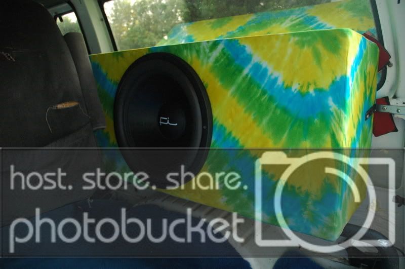

Need aero port plans. Box alreaty built
also right now i have the sub pointed sidways right to left do you think it would sound better if i had it pointing up. If i had it up i could do. at least 50 x 20 x 20 which would give me 9.2 before displacement to work with. Also im trying to get the most sq i can out of it while still being deafening loud(the reason i had it sealed but its not liking its current box
its car dependent, but most people say for suv's that pointing it up is louder, not sure bout SQ tho,
also here's a port calculator
http://www.darkscience.com.au/caraudiohowto/slotcalc/
if you add the inch to the depth and fire the sub and port up, i get this:
http://www.subwoofertools.com/forum/ported-box.asp?Ew=50&Eh=21&Dia=11&Xmax=24&Vd=.2&NumW=1&Vb=7.6&Fb=28&Qts=&Vas=&Fs=&CE=0
note: i decreased the port width from 6" to 5"
maybe someone with more experience with 18" woofers can comment on whether or not that's enough port area and/or if that's a big enough box. (seems pretty big to me //content.invisioncic.com/y282845/emoticons/smile.gif.1ebc41e1811405b213edfc4622c41e27.gif)
back isnt really an option cause it needs to be set up like this
and it would be right up against the corner with no room for a port
