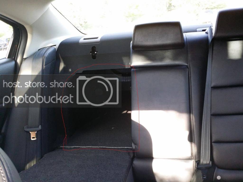

Thank you very much for all your advise on this topic. Yea I see what you mean about allot of people frowning upon this but trust me I'm not going to be blasting it in residential areas. That's a great Idea on that line level controller. I can put it rite next my subwoofer controller. I have a quite a bit of speakon cables at home I just have to buy the ones for the box. If you see the back seat On the right I have a 15x16 space that I would LOVE to build the box for. This way I can put the seat down when I want to.That would be really Ideal for me so I don't have to ride around with a box laying on my back seats. The only problem is there's really no way I can fit 2 8" speakers and 2 tweeters. That's why I was wondering If they made some pretty good 6" speakers. Or maybe I would just settle for 1 8" or 10" setup should still be plenty loud. I would just have to find a 4 ohm subwoofer and a 4 channel amp so I can bridge 2channels for the woofer and run the other 2 channels to each tweeter.

Are you trying to run a whole 3 way system out of 1 box? IE: Sub , mid , tweet? The way i've seen people do it, is they would have all their subs and whatnot in their trunk, (Bass is omidirectional) and have their removable box filled with mids and tweets. This is what I would recommend. It would be difficult to build one box with all 3, as you would have to separate the sub and mid.
You could have your subs in your trunk, and maybe build a box for two 6's and two horns (Compression drivers):
FaitalPRO 6FE200 6" Professional Midrange Speaker 4 Ohm
Same line of speaker I mentioned earlier, just a 6" version.
If it's going to be removable and set on your roof for parties, "Tweeters" could do just fine, but I really recommend compression drivers as I said earlier. They will get so much louder and sound great too. Nobody uses them inside the car as they're really hard to do right, but since you want it to also be removable (Right?) and able to bump for parties, I would definitely recommend this route.

No def ..not a 3way system. I currently have a 10" sub in the car rite now. But yea that 6" setup sounds perfect for me. I'm going to give it a shot.
