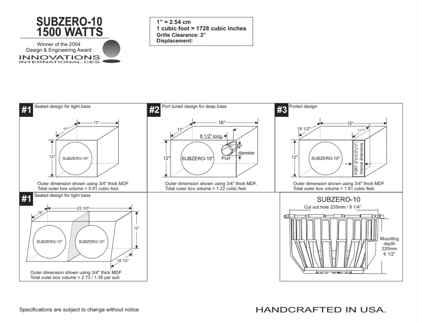

Need advice on my audio system setup, not getting much power from my sub
I agree with CRX. Everything seems perfectly matched so best step is a ported box.View attachment 25940
The #3 slot style with port in rear coming out the side instead of front ... so port can load about 8"s off the side ...would be perfect ....Sub would need to be mounted as close to edge as possible not center of enclosure over top of the port opening ....giving sound wave longest path of travel ..

OP if you need a box design, or want one, I can do one for you. We can try out hispls advice as well and maybe side fire.
