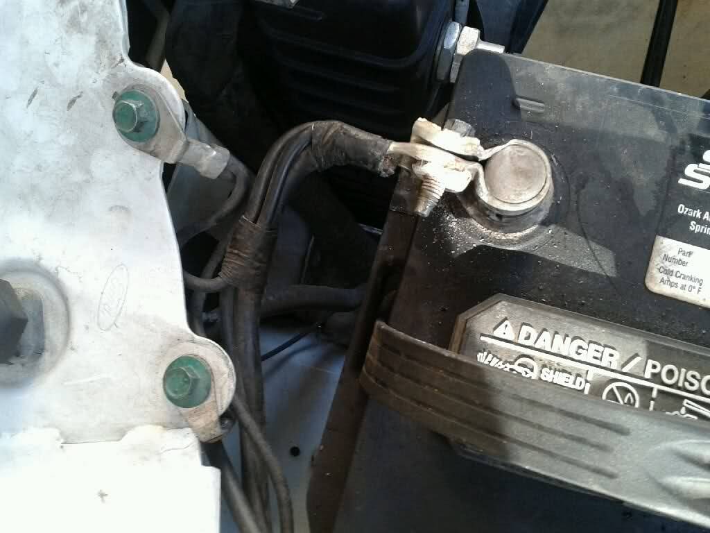

is this the factory ground for my battery? there's a lot of wires and i think this would be it but i can't tell and if it is it it's a pretty bad ground i think. the car is a 2003 mustang btw

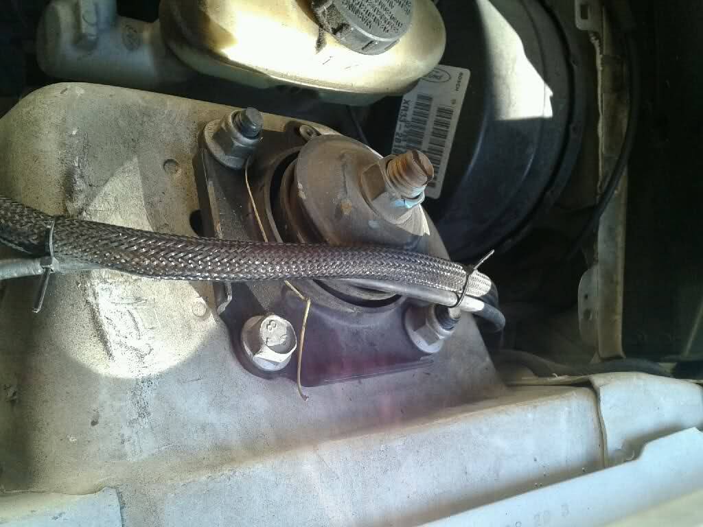

also would this be a better ground? i think it's the strut tower not sure though

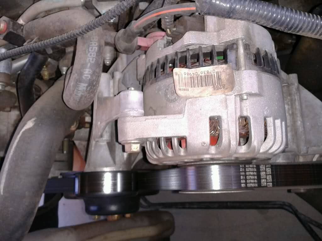

one more thing i'm confused on the engine block to chassis where on the engine block do i put it? i'm not very good at these kinds of things
its the bolt on the very left in that pic of your alt.... this runs to the frame. and then another wire from frame to battery neg.
so i run the wire from the bolt on the left of the alternator in the pic to the battery? and then what do i run for the engine to the frame? sorry i just want to make sure for sure i'm not good at this but i appreciate the help very much
