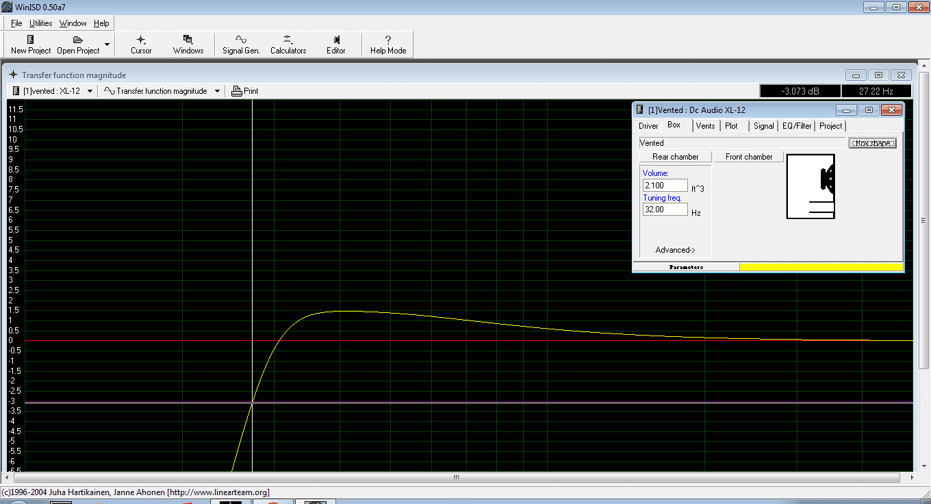

u want sub and port on front? my box is 2.1 cf ad 30 sq in port total (in avatar) i can just design 1 tad smaller (not as wide probably already have 1 in my folder) but i can't do cut sheets.. how much bracing u want? how much port per cf? but idk rear port air velocity with out modeling like pm said.. how much power u running to it? they rec 1.75cf for it? dc usually smaller than that

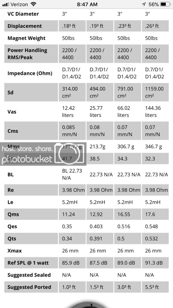

Specs for the XL 12” are the 2nd row from the left.

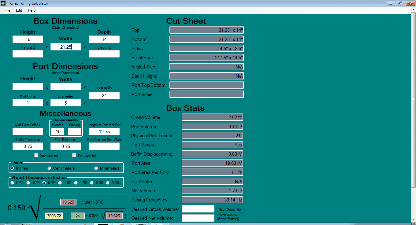

Important... ill give you a Torres sheet to get started... modeled for your power
The box would have to 15.5” high max and 1.5” more to meet the deck. Maybe do a round port that I can extend up to meet the cutout in the deck.
Cant help ya then... the port needs to be way longer... maybe if you use a 90 degree elbow... 1.5"-2" external?... wow... thats a tall order... the best solution was a pair of 4" aeros or a single 5" round, but the length will be 24" at least... thoughts?... here is a quick and dirty example...
I'd tweak it if I knew how you're gonna deal with the port length issue... that 5" round looks the best to me BTW for your power
