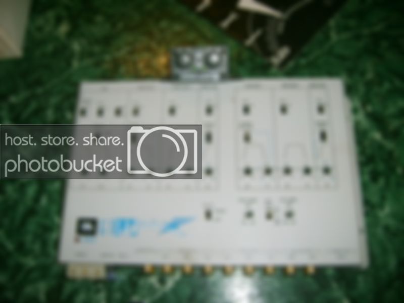

I have a really nice BNIB old shool 4 way JBL crossover like this one....
