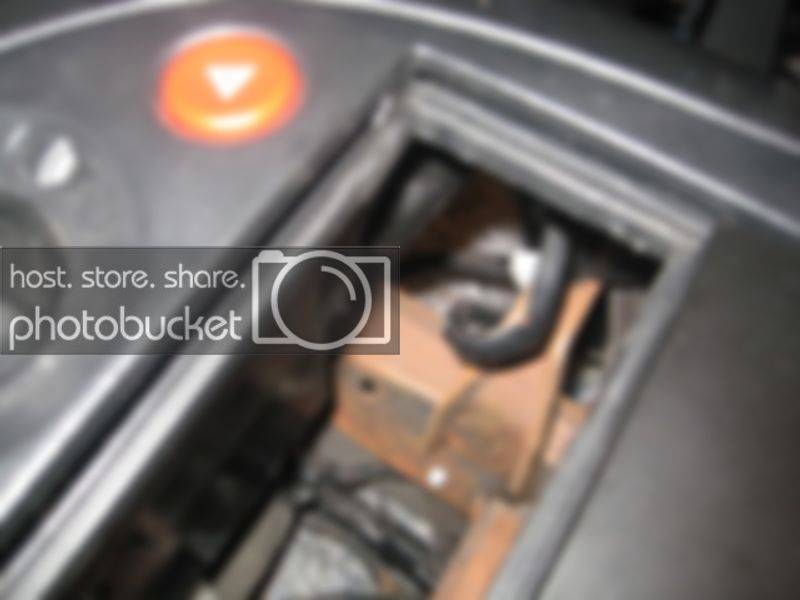

I'm just getting started on the install... but i went to test fit the head unit and it appears to be smaller than DIN size??? is this possible? its also ridiculously long, making it stick out, and not be flush. i can resess it into the dash, but im not sure about making it fit flush. the trim ring just seems to be too small in both width and height! //content.invisioncic.com/y282845/emoticons/frown.gif.a3531fa0534503350665a1e957861287.gif
does anyone have pictures of some CD700's installed? i just did a cd500 in my other car and did not have any issues //content.invisioncic.com/y282845/emoticons/verymad.gif.3f39c5c2fd57527b671fad3efdfac756.gif -heath

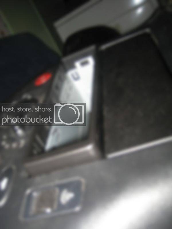

ok so with it in the dimensions appear to be ok, besides how much it hangs out. That apparently is the REAL problem. they designed it to NOT sit flush, which really irritates me as there is plenty of room in back to allow it to be flush mounted.

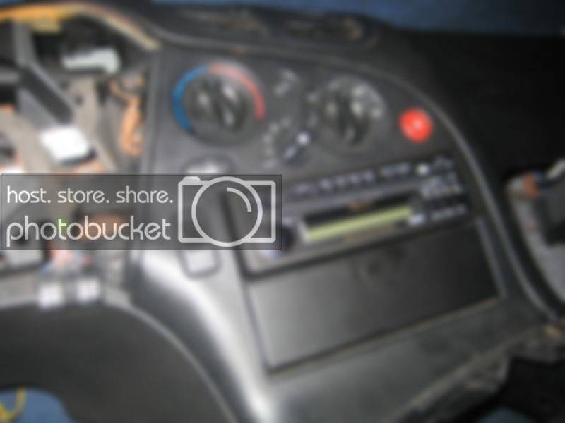

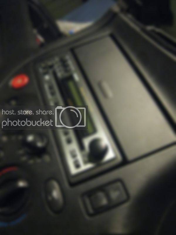

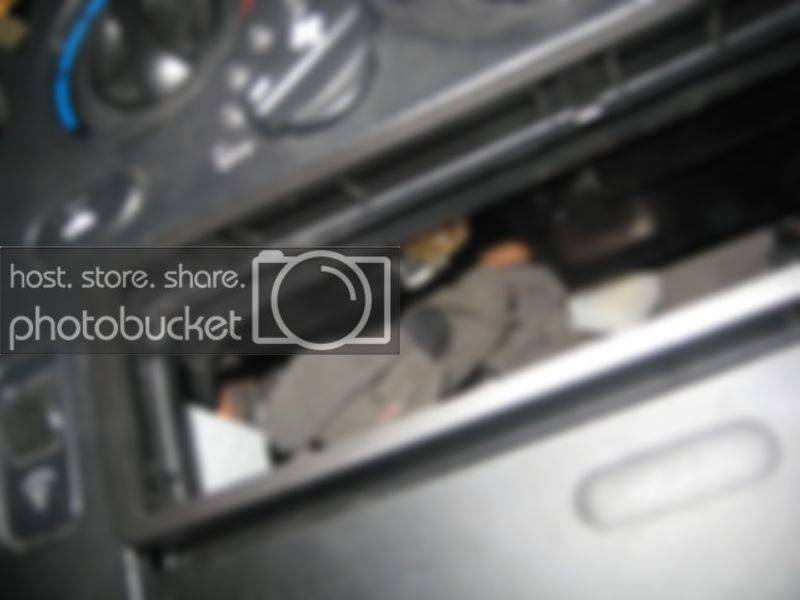

So now my question is, has anyone FLUSH MOUNTED one of these decks. It looks like ill have to cut out the lip on which the cage is supposed to rest, and ill loose the mounting surface for the cage. anyone got any tips? here are some pics
-Heath //content.invisioncic.com/y282845/emoticons/frown.gif.a3531fa0534503350665a1e957861287.gif
pics of car too those are secks.

ok here are some preliminary pics. i spend a few hours fiddling with the mounting lastnight. the cage is staying but i clipped the latch hooks for the headunit, and removed the side clips on the HU. I also trimmed the bezel ... i took off 7mm. my plan is to drill a few holes in the cage and screw the cage directly to the HU. We'll see how that goes tomorrow, but for now it at least fits. Now to drill the holes and get a small ratcheting 90 degree screw driver. its gonna be a ***** to remove down the road. //content.invisioncic.com/y282845/emoticons/smile.gif.1ebc41e1811405b213edfc4622c41e27.gif Now to find a place for the external processor/preamp //content.invisioncic.com/y282845/emoticons/biggrin.gif.d71a5d36fcbab170f2364c9f2e3946cb.gif
-Heath
