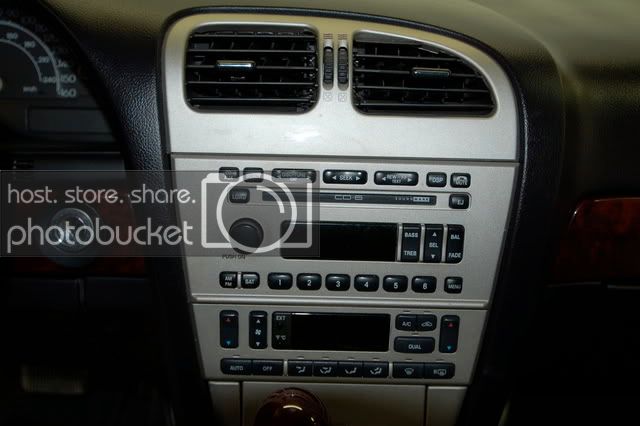

The factory head unit

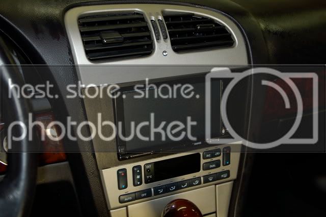

Now with the Alpine IVA-W205

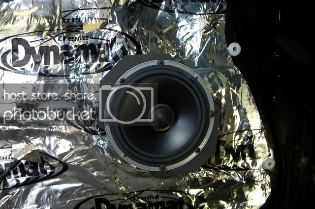

Door with panel removed, Dynamat added
Hole for the factory 5x7 speaker. Notice the bracket around the opening. JL Audio did not have the C5 5x7's ready for shipping just yet to Audio Advisors. So we went with a C5 6.5 model in it's place
JL Audio C5 6.5 coaxial

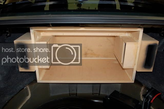

Enclosure for the 13W6. The original plan was to have a single port running across the top of the subwoofer. We later found that we didn't have the clearance. I expressed to JC that I didn't like the look of a single port off to one side of the sub (Hence why I wanted one going across the top). Doesn't look symetrical, a little tacky. So JC put in a call to JL Audio and they sent the specs for a dual slotted ported enclosure, for a nice even look.

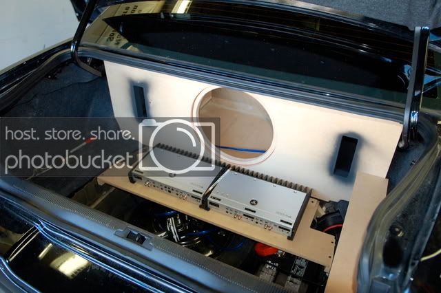

Trim panel mounted to enclosure to give it that sealed off "wall" look. Amp rack mounted. Four screws hold the rack and allow for it to be slightly lifted should the spare tire really be needed

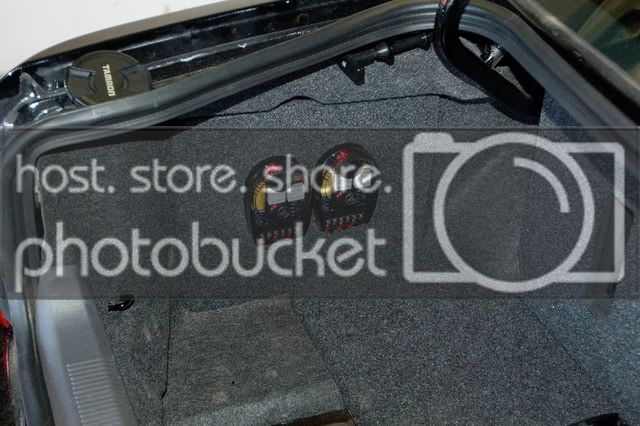

C5 crossovers mounted in pairs on either side of the trunk
