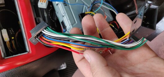

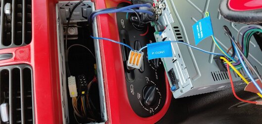

Ok so here's the situation. I reconnected the blue wire back into the old harness and I was thinking of just using the old harness with the new HU altogether. But the problem is that the pins are on different locations on the two harnessess so I guess they can't be interchangeable. I also thought of wiring the blue wire thing with the grey plastic block onto the new harness where there is already a blue-and-white wire. But the thing is, my new HU has a built-in amplifier (or so I have heard) and if I replaced that blue-white wire on the new harness would it eliminate the built-in amp of the HU? For clarification, the new harness is the one I'm holding in hand and old one is sticking out of the hole.

Looks connected from your first picture. Is your Alpine amp turning on? Subwoofer setting is probably turned off on the headunit.
Yeah I connected the blue wire that I earlier disconnected (probably what was causing the lack of bass) into the old kenwood's harness (or to the grey-orange block in the middle of the wire where I first had pulled it out of). However I can't connect the old harness into my Sony HU because the pins aren't in right order and one connector broke. So I could only use the new harness but that blue wire that I need to get in the new sony's harness is connected to the old harness. And the bass isn't there when using only the new harness without the blue wire thing shown in the first picture.
The remote wiring going to your alpine amp wont be in a harness. It's a standalone wire that runs to the amp terminal and connects to the blue remote wiring coming from the headunit harness.
Okay, so I just split the blue wire in which I connect the amp wire?
