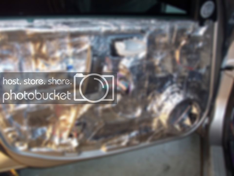

Drivers door w/ deadener...

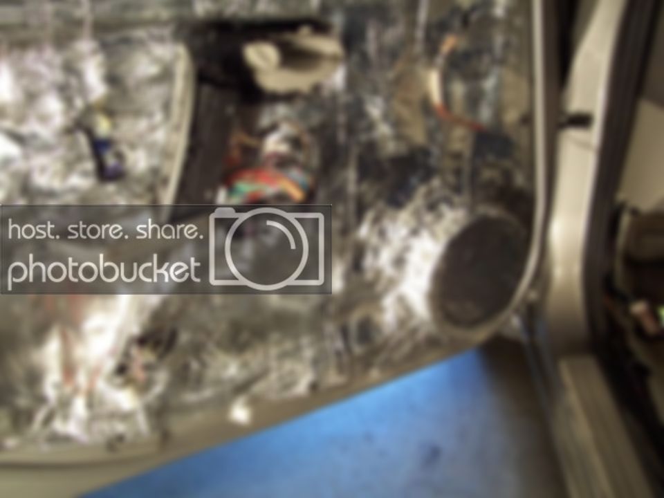

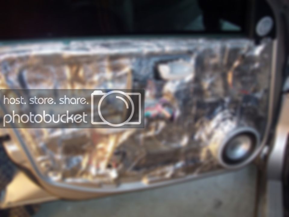

Drivers door w/ mid mounted...

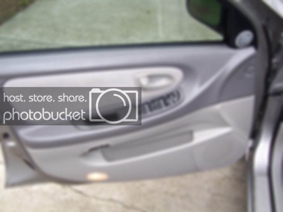

All put together again...

Just a word to the wise. Consider using screws less then the thickness of the top mounting baffle. If it's 3/4" MDF, then use 3/4" screws. Reason being with a high output driver like that, you might want to limit the amount of energy that would otherwise be transmitted through a long screw back to the door panel. Unless you've decoupled the entire baffle from the door steel, then I think you'd be ok.
You might also consider soaking that MDF in fiberglass resin or using some Rustolium or bedliner spray on them to keep them from breaking down.

I used 4 screws to mount the first 3 rings, then another set on the final ring, and yet another on the drivers. I did that to eliminate exactly what you are reffering too. Do you think that method is effective?
I noticed the old rings I had were done for. would a latex based paint work, or should I go get some rustolium? I was suprised at how much the old rings had expanded and fallen apart.
Chris, you could also just use knife inserts, this will Completely eliminate any contact between each ring. Alot of times if not predrilled the rings will make an attempt to seperate with large screws. It Will go through, but the attempt has been made thus potentially weakening the overall structure and opening you up for future possible seperation.
