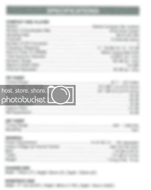

interesting. The article I read said 4V, I guess Alpine would be a better source.
A little off topic but here is a screenshot out of the 7909 manual:
To provide a clearer picture my amp is a Alpine MRV-F345
