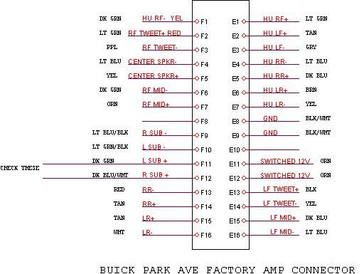

Visit Critchfield and get a vehicle specific adapter for your car/system. I have a pinout for the connector at the factory amp for a 99 Park Ave if that helps.
