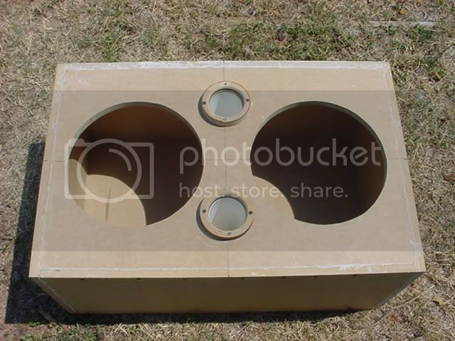

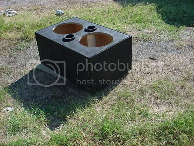

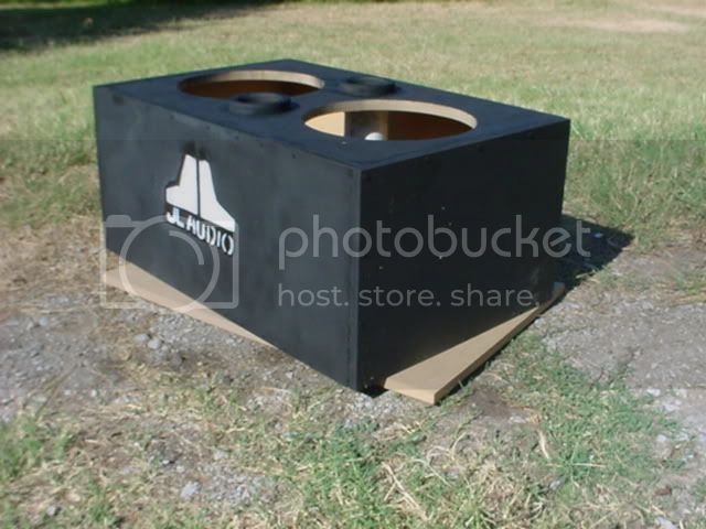

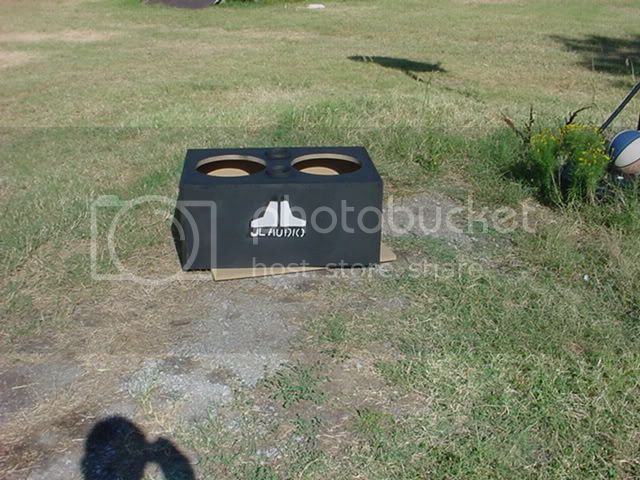

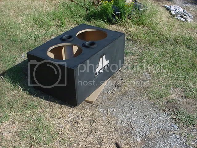

This is a 3.6 cube box. Ported to 30.8 hz. It is for 2 JL Audio 12w3's. I was pleased with how it came out, no gaps or anything. Cant wait to hear it when I deliver it Friday. Only cost $45 to build. It is not completely finished yet. I painted it flat black with a white JL logo. The logo sucks so im probably just going to coat it with spray on bed liner. Let me know what you think.

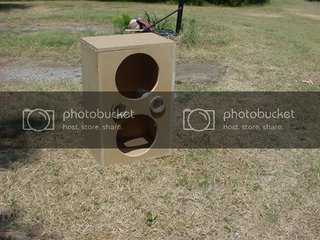

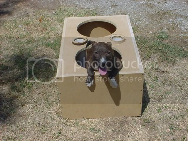

I needed a woofer to test the box out lol

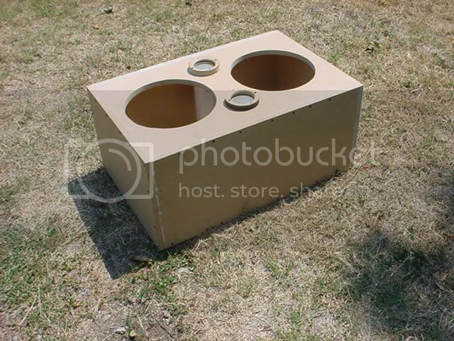

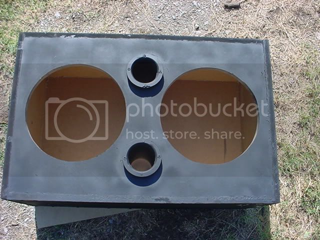

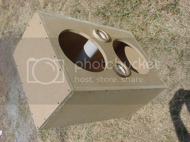

I originally planned on 4 inch ports but space on the baffle were a bit limited. Also did you notice the ringed flares on the ports? The ports are also attached the the rings and to the box so the ports arent going anywhere.
