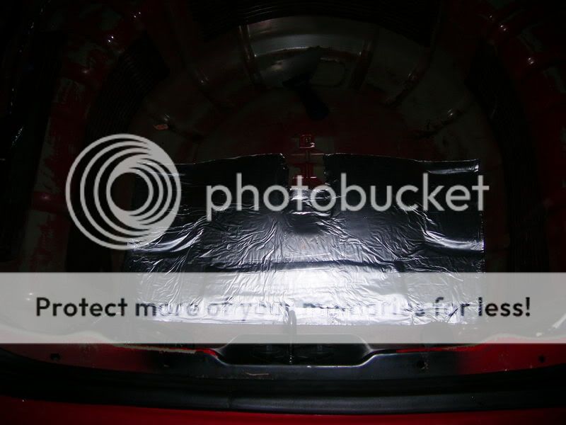

shitty picture ftw. just put one little sheet down to see how it would work out. seems to be fine.
Did you prep it at all?
What did you use to flatten it?
Lots of Pics of the eDead!
i wiped it down with some of that rubbing alcohol stuff (which i dont reccomend) it took the top layer of paint off, but didnt mess with the undercoat, so yes...it was a clean surface. dbornotdb on here told me to use wax and grease remover instead, so I think i will go to the sherwin williams store across the road tomorrow and pic some up.
as for what I rolled it with, I used a little 1 inch pvc roller that lowes had in the wallpaper tool section.
