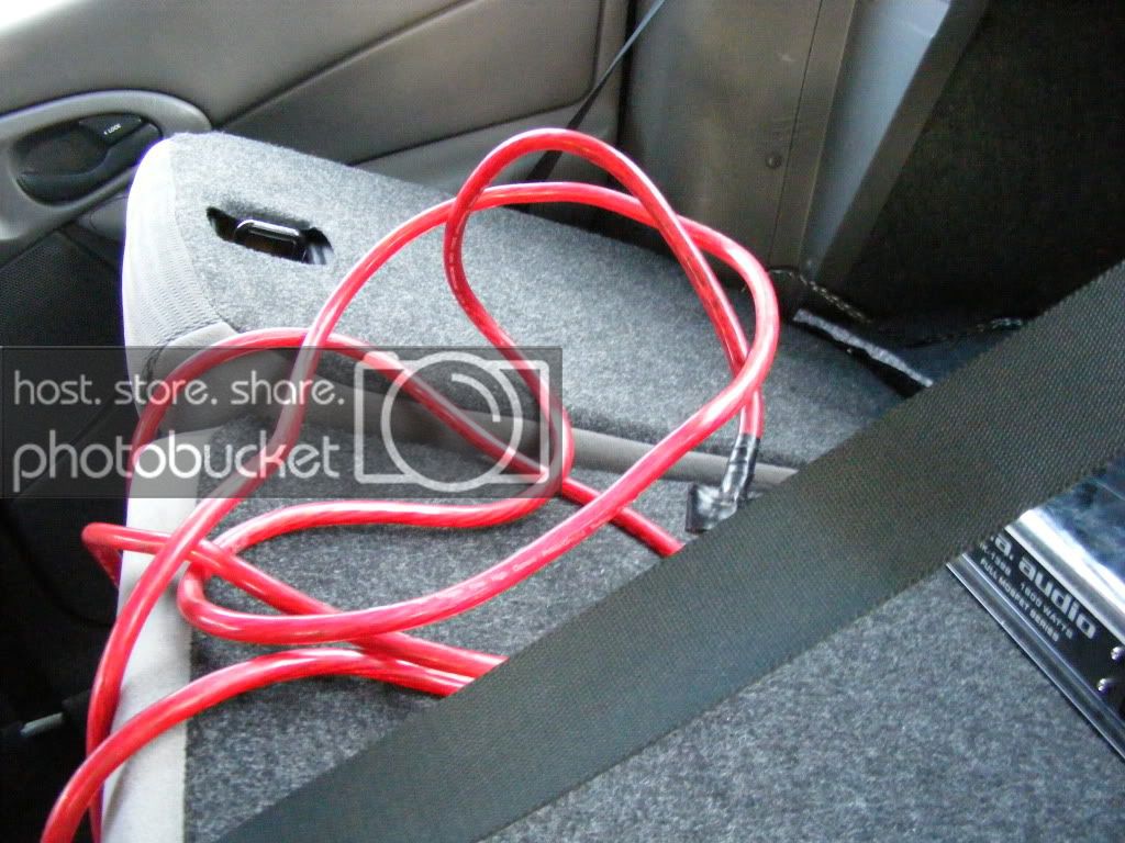

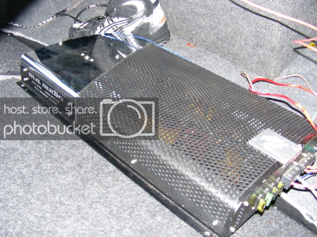

MUCH bigger amp only hooked up to the 12 gauge wire to test
4 gauge wire

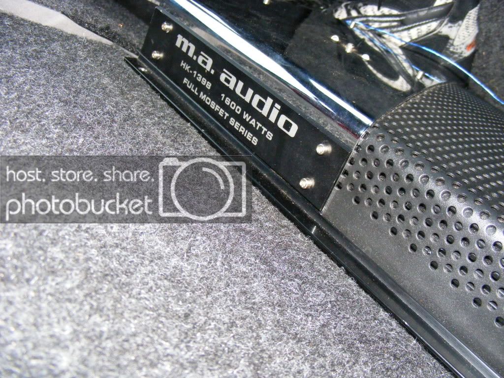

Amp model #

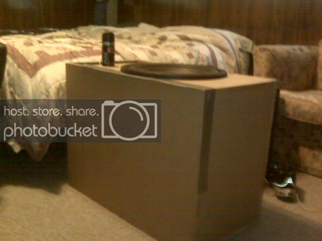

Well this week me and my dad are building a much better box 4 cubes at 36 hz vs the current box which is BELOW memphis's recommended minimum volume for a ported box so it should be much louder
good job so far i guess...not the greatest (but is getting better) and YOU are doing it and learning. I read through this entire thread and thank you for fixing that power wire, looks much better and is much safer. Now your going to need atleast 4 gauge ran for that new amp...and you will need to get a real fuse block. Amp screwed to the box is bad. Use Titebond wood glue when you build your new box. Good job so far and keep us all posted brother:cool:

Box is almost done right now its just screwed not glued yet cuz we wanted to peice it together and i decided to give it a try its louder with less power but the leaks are evident soon to be fixed pic in a minute but next weekend im doing a big 3 with the 4 gauge in my car now and im running some home depot 4 gauge (it was supposed to be $.99 a foot but some how we only ended up paying $.59 a foot and i did check the diameter of the wire it was 5mm which is how much 4 gauge is supposed to be) for my power and ground. and ill prolly be ordering a hu from crutchfield a flip of dvd by jensen (i know jensen sucks but im in highschool and flip up touchscreens look badass + i have yet to hear a car at my school come close to touching the sound quality of my car and i have a stock hu in and stock doors)
