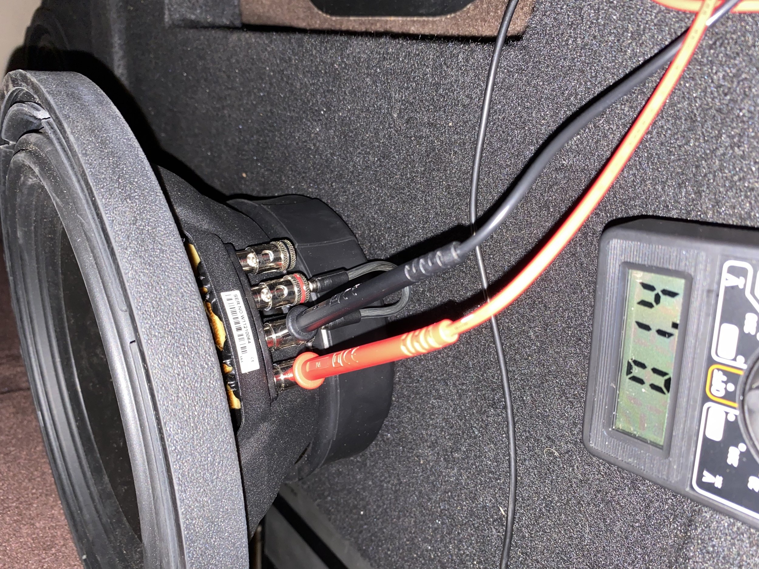

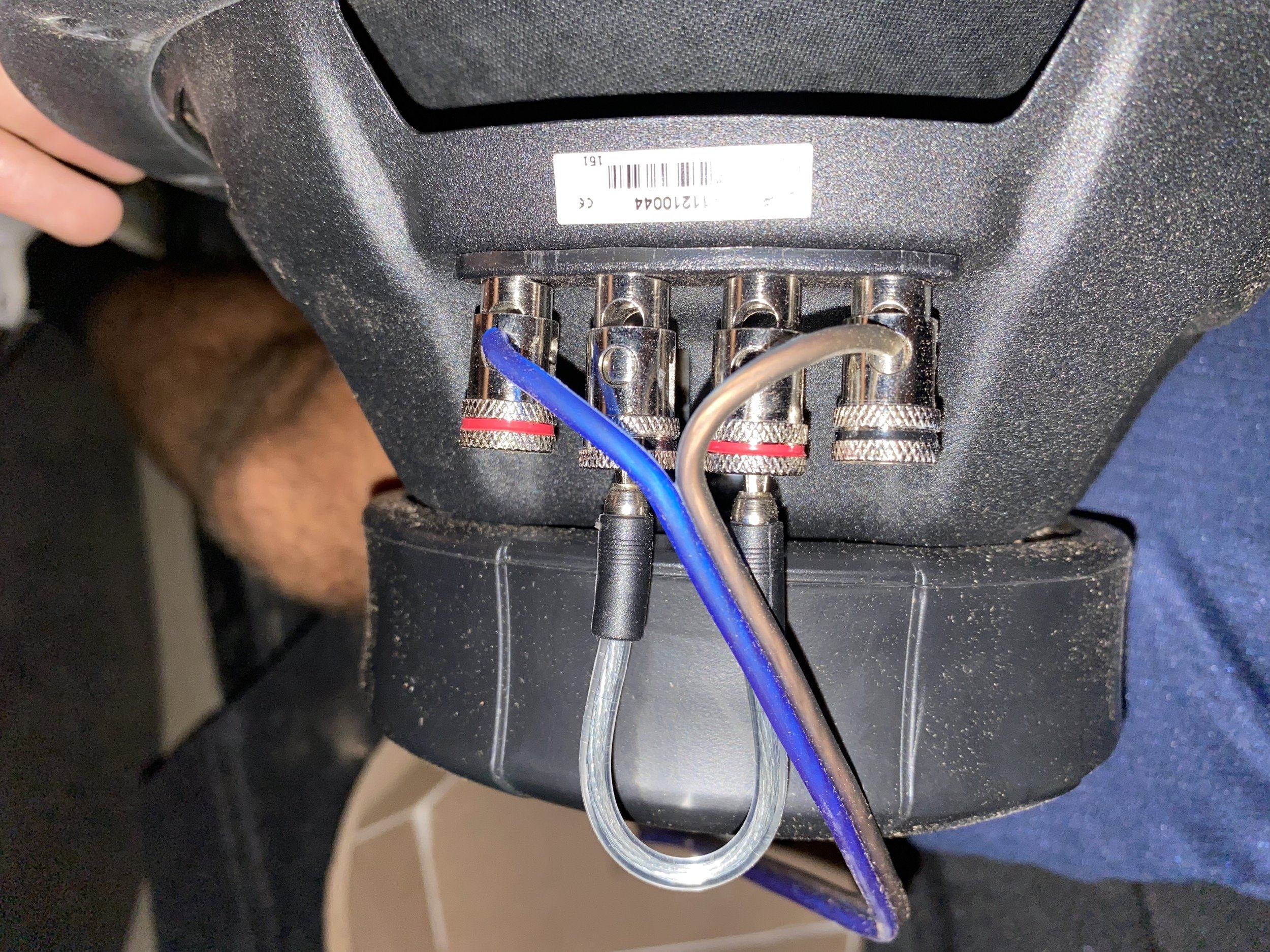

Yes I did. Here is how the subs came wired from the manufacturer. I connected the negative wires of both subs and put them in one of the neg terminals and did the same with the positive in one of the positive terminals.

You can check with a DMM on Ohm Settings to check the final two wires(One Poss and One Neg ) that go to the amplifier to make certain that the final Ohm load is within the 2 ohm Limitations. will not be exactly 2 ohms, more like 1.8 up to 2.3. If it jumps around alot then You may have a bad coil on one of the subs. You will need to check each coil individually without any wires attached, and be around the same limitations. quite possible you may have a bad coil on one of the subs as you stated a "Rattle " from one of the subs?

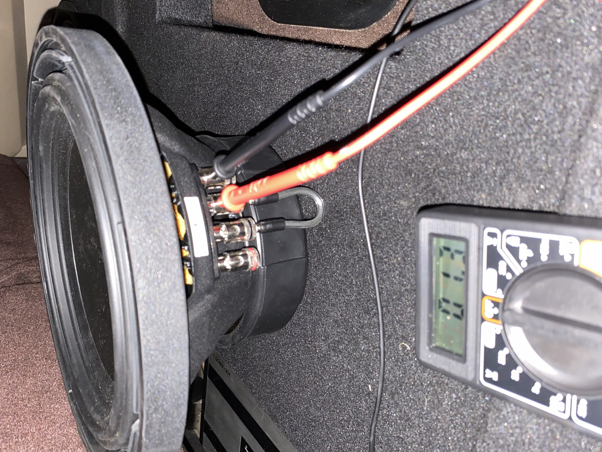

Checking the last two wires from the subs that go into the amp and it’s showing around 1.5 ohms. Would that mean the amp is the problem then? Gonna check both the coils on the sub I think is bad and will get back to you. Also I contacted the seller and they offered to send me a new amp once I return mine and possibly another sub if I test it and it seems defective.
Tested the sub that was rattling and showed around 1.5 ohms. So might just be the box rattling I’m not too sure, it does seem to make some noises that the other sun doesn’t. Almost crackling.

Need to remove the Jumper wires and test each coil Pos Neg and Poss neg. Subs have Two 2ohm voice coils. See if both are close to 2 ohms each. I know its a PITA but need check Ea coil. With the Jumper your are within the 1 ohm limitations, But need check ea coil for 2 ohms. very well could be the enclosure rattling if its leaking or flexing without some bracing
You need to remove the Neg on the DMM where it is and put it in the Neg terminal on the other Coil that has nothing in it to read a final Ohm Load on the Speaker with the DMM and Jumper installed. It should read close to 4 Ohms If it is a DVC2
