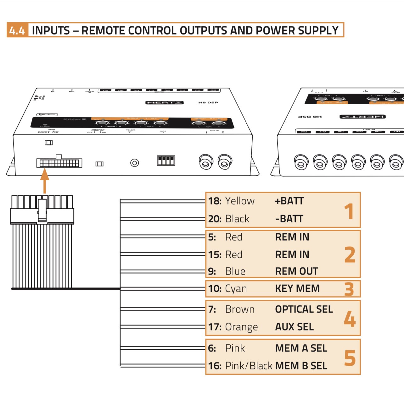

Now my problem is I have no idea what any of these other wires are even for.
REM IN
REM IN
KEY MEM
Optical sel
Aux sel
MEM a sel
MEM b sel
can can any one please help out please
REM IN
REM IN
KEY MEM
Optical sel
Aux sel
MEM a sel
MEM b sel
Remote in is pretty self-explanatory. It's the remote signal from your headunit.
Key mem I'm not sure
Optical select needs 12v power if you are using the optical input.
Aux sel needs 12v power is you are using aux input
Mem A and mem B are for selecting either of the saved tunes in the unit. Also 12v power if I'm not mistaken.
Matt
Matt
thanks dude thats by far the best feed back ive got, as for the key mem, i belive thats for a ACC to turn it on.
