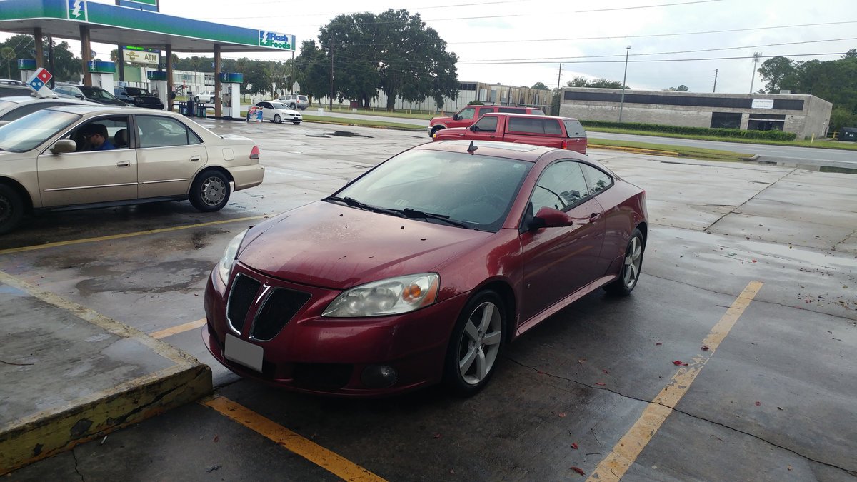

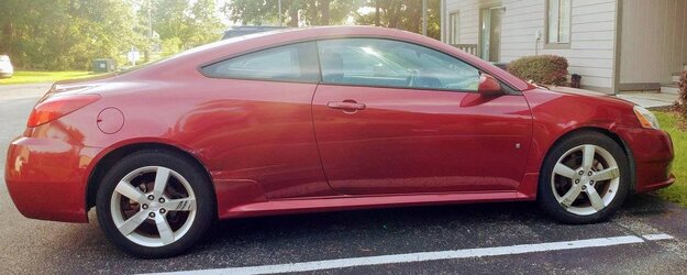

It's a go!!! The co-worker I spoke about, with the Pontiac G6 GT, out of the blue told me today that he can sell me the car soon if I still want it. Ummmm yeah, duh!! Soon I will have my platform to build my stereo in. 2008 G6 GT Coupe. Black leather interior. It has MINOR exterior cosmetic damage but other than that, it's in great shape with remote start. So I am thinking.... my 3sixty.3, Scanspeak mids and highs, my US Acoustics amps, a second battery, and perhaps a Dayton sub.... I am getting excited now lol.
Here is a pic of the actual car.

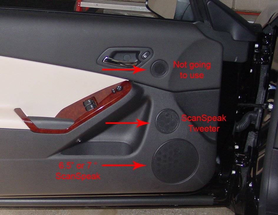

I got a better look at the car today. I am happy to say it has the door panels with 3 speaker locations in each door which means I can mount the tweeters close to the mid-woofer.
The door panel pic is just for illustration, they are all black in the car I am getting.
The car pic is the actual car... purdy ain't it?
dude congratz~ that's a sweet ride. Those are hard to come by nowadays. I bet you're gonna have hella fun in that. one suggestion.. have you thought of maybe going 3 way active? It's already made for it and it'll be better for imaging if your tweeter is up top. You already have a full blown dsp, might as well take advantage of the extra 2 channels. It'll be so much more worth the effort IMO.
Thanks... I thought about the 3 way active real hard, I mean real hard. What I am going to do is as soon as the car is able to be worked on I am going to remove the door panel and do some measuring of ALL three locations, just in case. Once I am able to see the angle of the factory tweeter location I can better make up my mind. If I go 3 way active, I will need another amp. I am not sure I want to run 3 amplifiers though. I don't want to modify anything visible to mount the speakers because I want a stealth system. Most likely I will go 2 way active with the tweeter near the woofer. 3 way is by no means out of the picture. The rear deck speakers are coming out and the holes will be left as pass through holes for the pressure waves from the sub. Since the car is maroon in color I will be using my red and black 12awg speaker wires when I run the wires to the doors. I know... overkill right lol. That leaves me with 100ft of blue and black 12awg speaker wire... I guess I can use that on my sisters new Jeep.
You've been given the most wonderful gift of a factory 3-way.
Please use it. You have the processing already.
