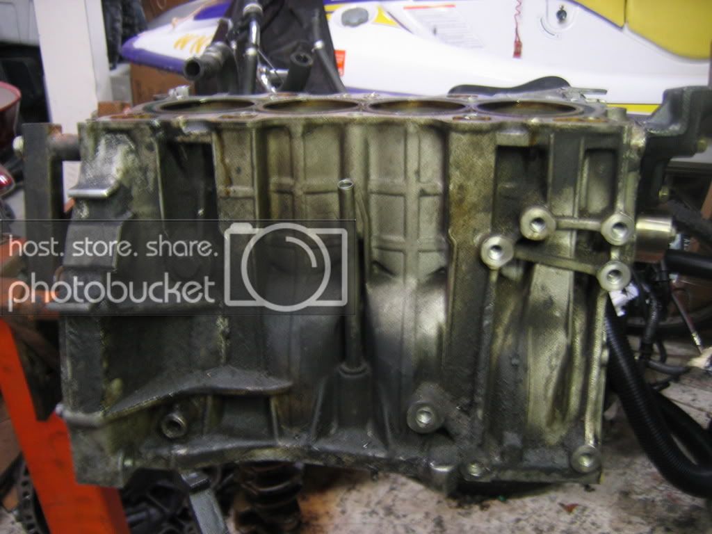

Well, got some more progress in tonight. Trying to finish this while still having fun too.

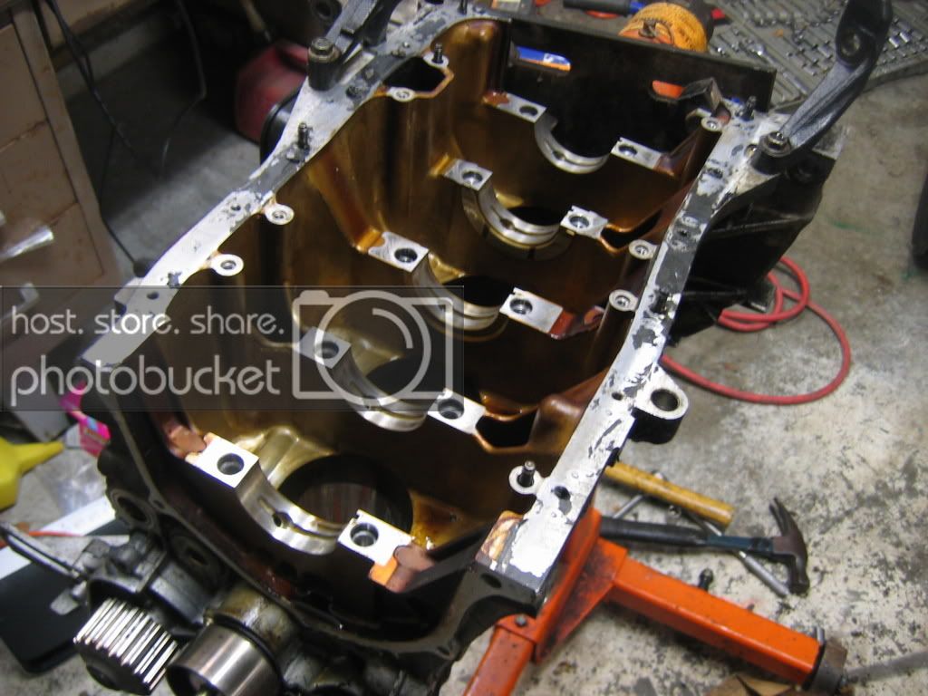

The block is pretty much stripped besides the water pump and belt tensioner.
I'm going to honda sometime soon and ordering some stuff like a timing belt, bearings and a gasket kit. Also, I am taking my crank pulley to a machine shop to get the AC pulley taken off. It chipped and I'm not using AC anyways, so maybe it'll take a pound or two off.
Well, that's all I have for updates right now everyone

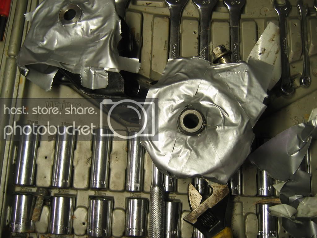

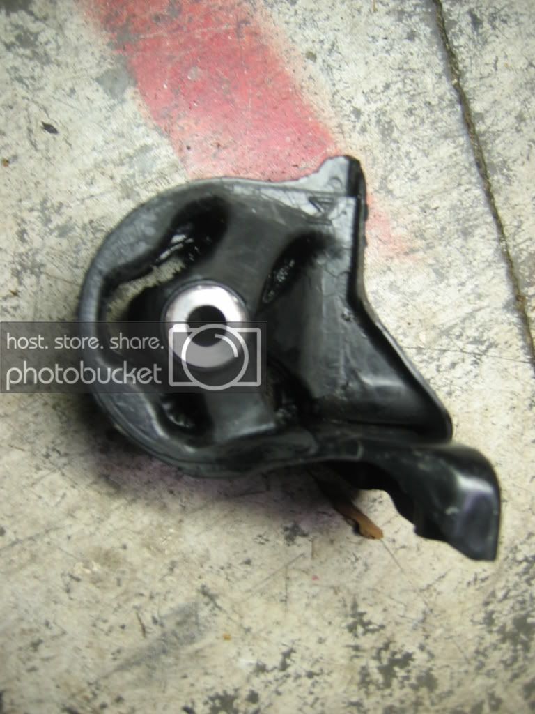

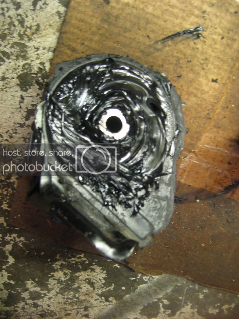

well, I made some mounts like you mentioned torgus. Bought some 3m caulking tube and they're hardening right now.
My first one looked pretty bad but they got better
Did that to 3 of them. I have to replace a mount since it was blown but will still do it to the new one. Thanks for the tip

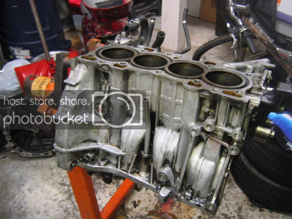

Also started cleaning the block for fun, probably finish it up tomorrow
Take that bish outside and spray it down with "greased lightning"...let it sit
in 10 minutes go back and spray it down again....let it sit
then just hose it off.
make sure you cover the top and bottom first:D

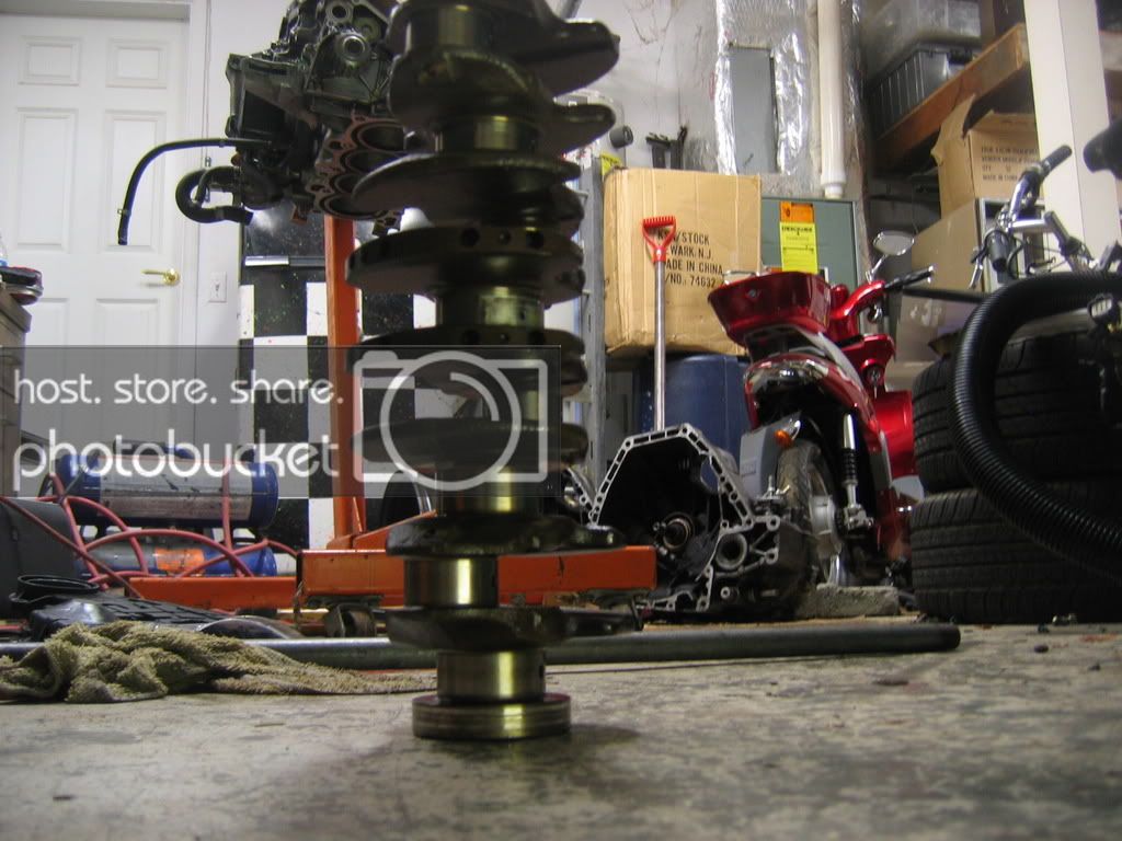

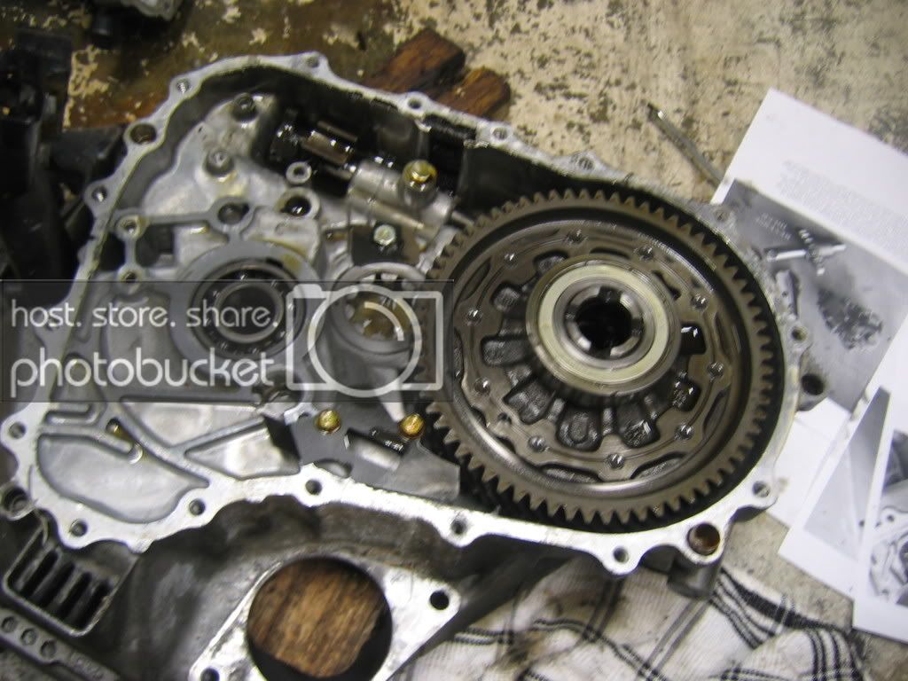

I was hoping to have this done already, again, but still am working on it. The transmission I bought had decent bearings but I thought I might as well do this all right the first time. Got another ****** from a friend with good bearings and longer gears, so I'm going to use the 5th gear from it as an overdrive for the highway since my gears are REALLY short. I'm just putting my short gears into this case with good bearings.
Here is some of the progress
Casing off

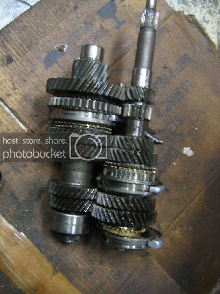

Here is the mainshaft and countershaft plus gears. The syncros are in really good condition too so I'm using them instead of the syncros in my b16 transmission.

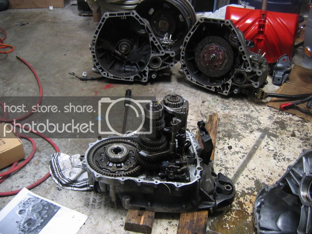

And lastly, stripped down besides differential. I decided to just leave it in and not mess with it.

I'm thinking about pressure washing it //content.invisioncic.com/y282845/emoticons/biggrin.gif.d71a5d36fcbab170f2364c9f2e3946cb.gif

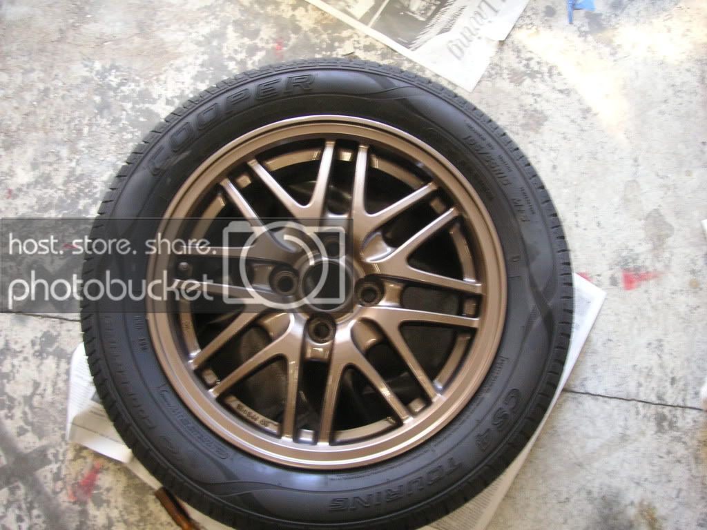

I was debating it. I like the silver look, but it would be nice to paint it a bronze to match my car. The old people who had it before took it to a pin striper and he painted it on, so I'm stuck with it. I decided to match everything else with it so it won't stand out as much.
I tried with painting my wheels, maybe I could find high heat paint this color
It kinda matched the pin stripe. I noticed it a lot more when the wheels were black though
Maybe if I find some bronze high heat paint, I may do it

nice job on the mounts btw! cheap and easy.
thanks. They're a little sloppy, but they will do the job. Thanks for suggesting it

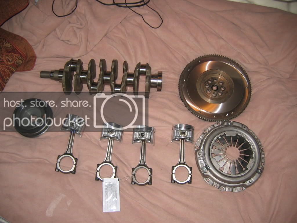

I have a few updates. I'm planning on finishing this friday or saturday if all goes well with my clearances.

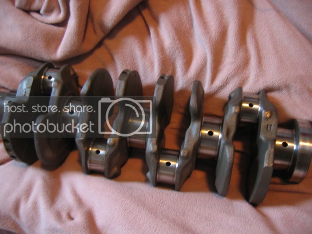

I got my bottom end balanced and rods shotpeened finally though. I was outta town for 2 weeks and got back yesterday. Dropped everything off 2 weeks before I left hoping they'd be done, but it took 3 weeks.
Here is everything though.
Everything is all balanced and it was a fairly good price for all the work done.
*Micro-Polished Crank

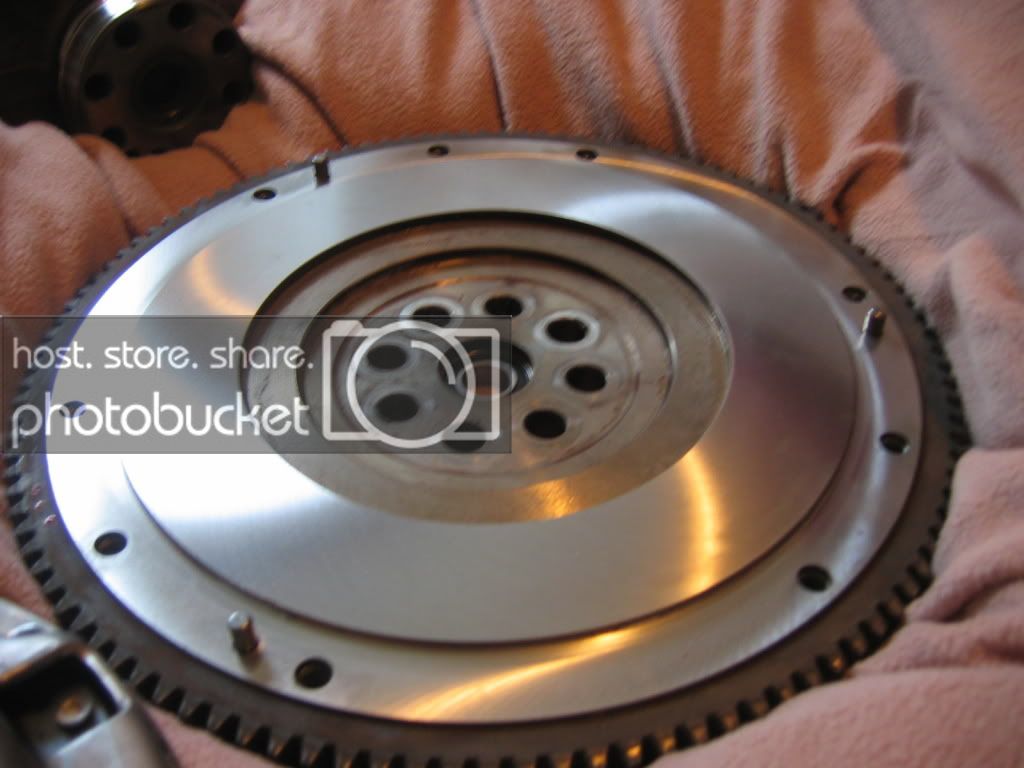

*Resurfaced flywheel

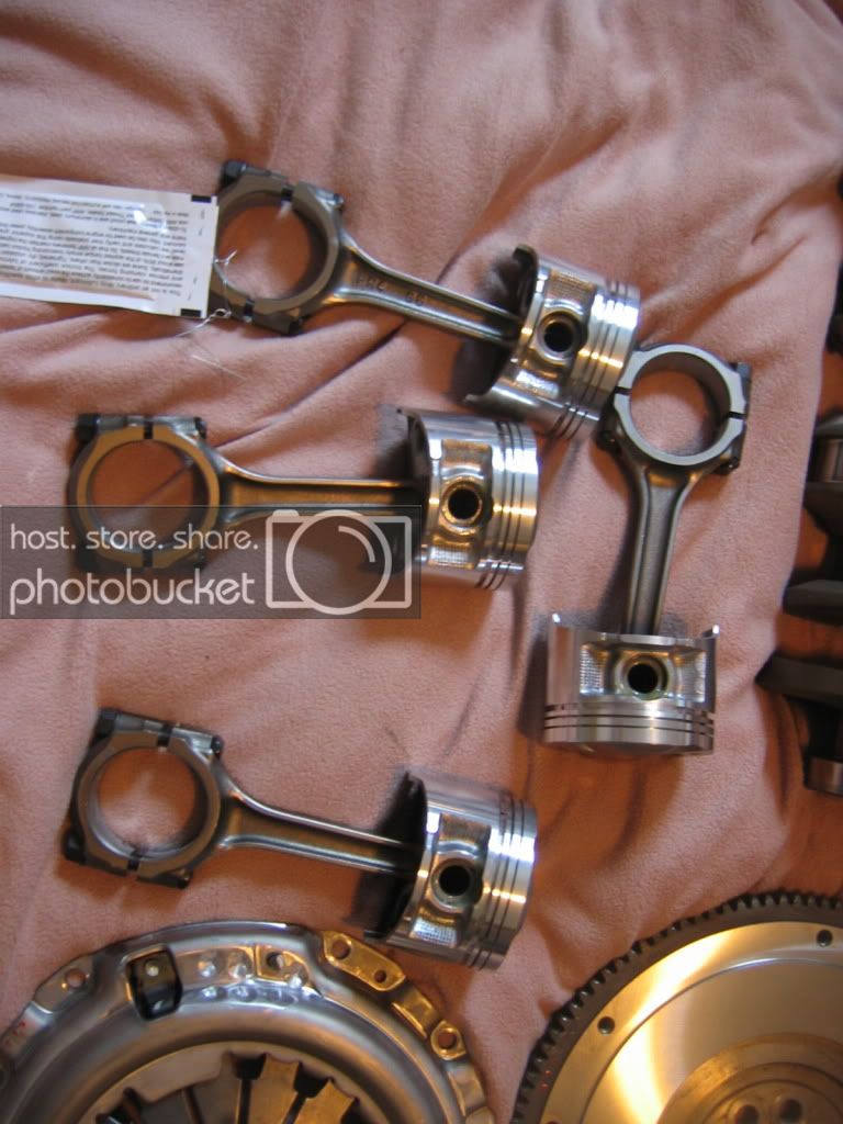

*Shotpeened LS Rods fitted with arp rod bolts and P30 Pistons on

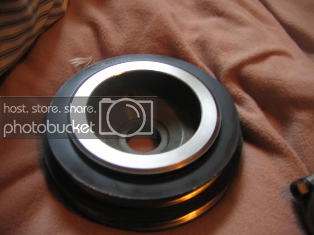

*Shaved Crank Pulley(I chipped the power steering pulley so had it shaved)
It looks unique the way it is shaved off. Not much lighter, but won't throw off the balance anymore
The rods look nice clean and shot peened as well. They feel smooth and have a more gray look
I'm ordering a gasket kit tomorrow along with bearings. I'll have to measure all the clearances and hope they all work out with standard bearings.
