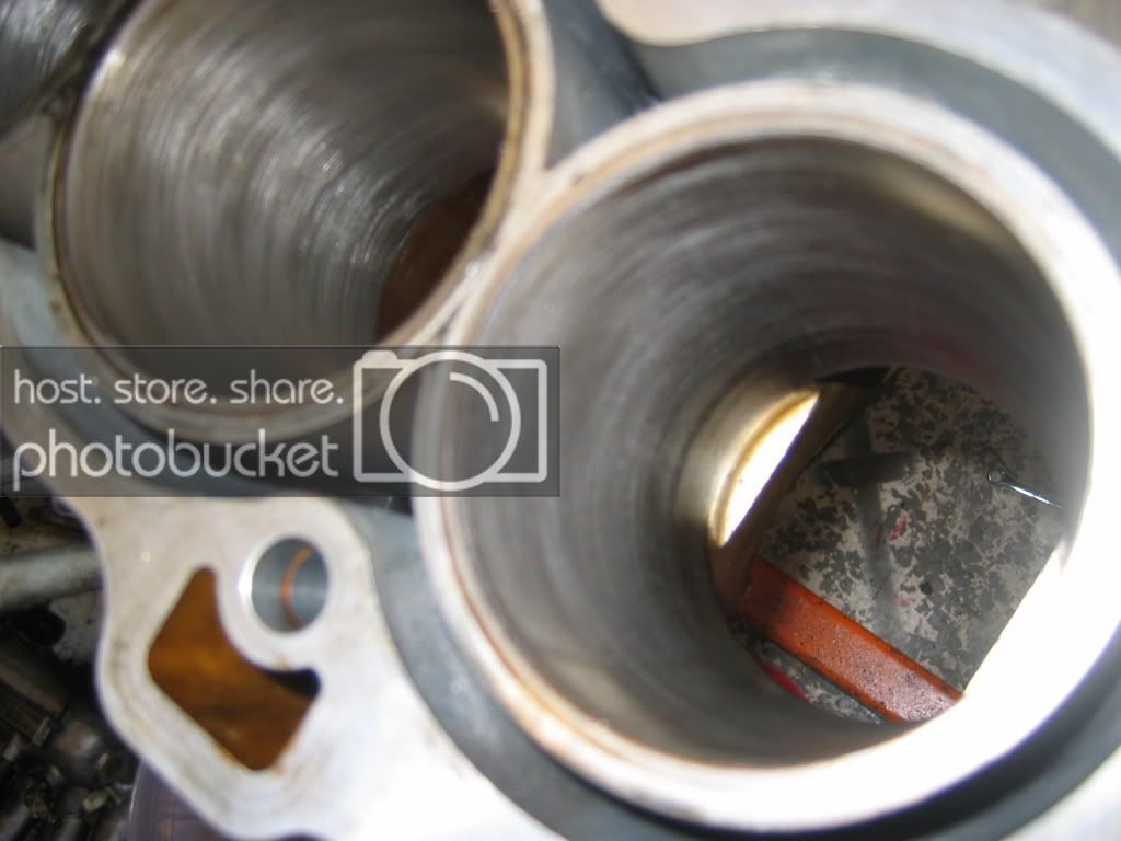

I finally have everything I need! I got my honing tool, gasket kit, timing belt, rod bearings, main bearings, thrust washers and a piston ring filer today.

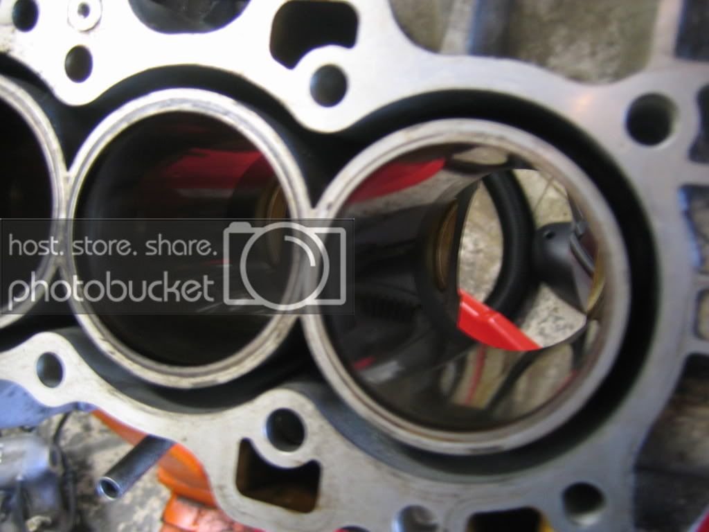

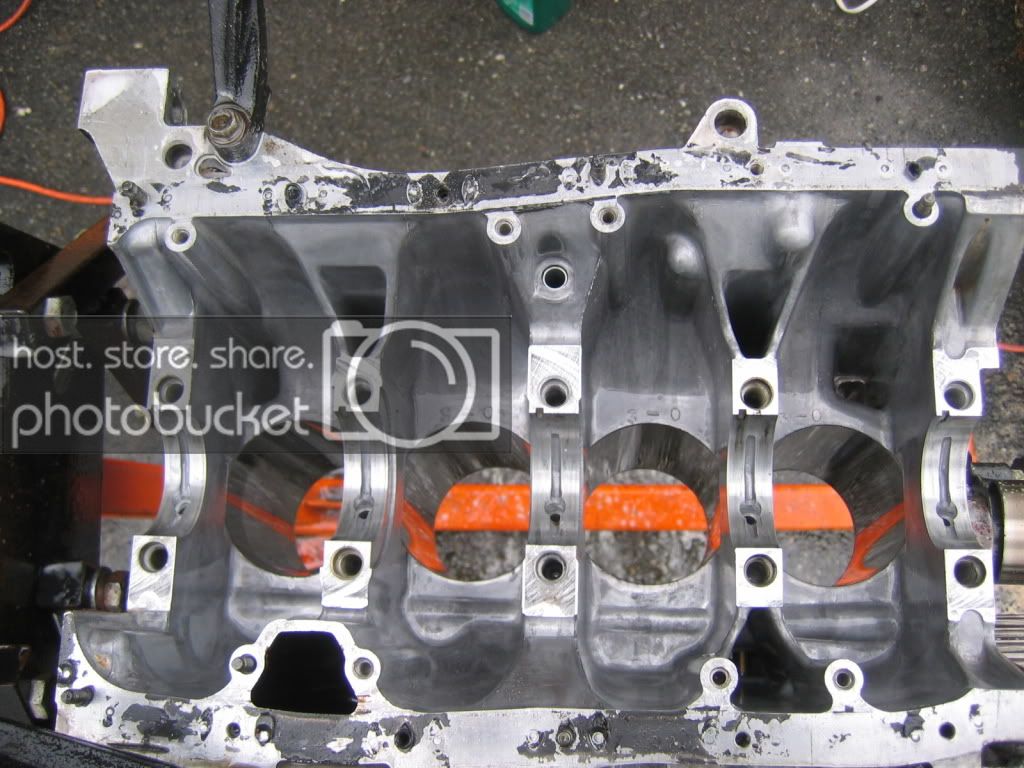

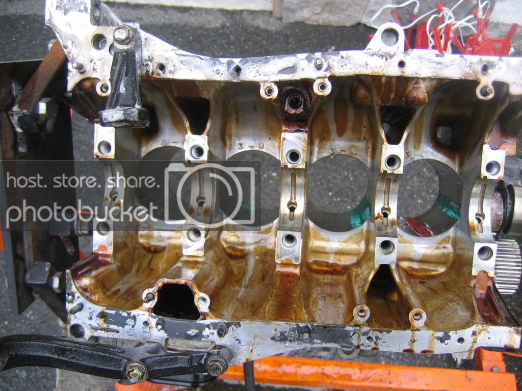

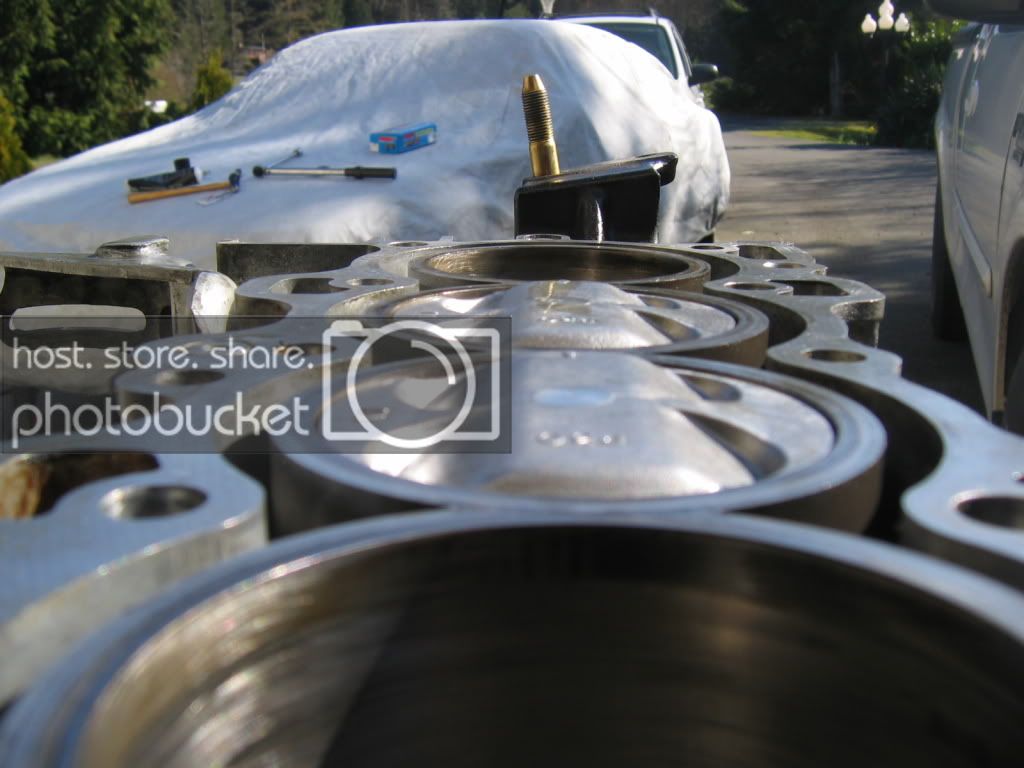

I already finished honing the cylinders and here are some pics right after I finished.

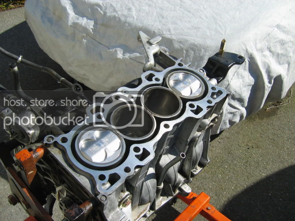

Well, the block was just about to be done yesterday but one of my piston rings chipped as I was putting it in. I ordered some replacements and they'll be here tomorrow.

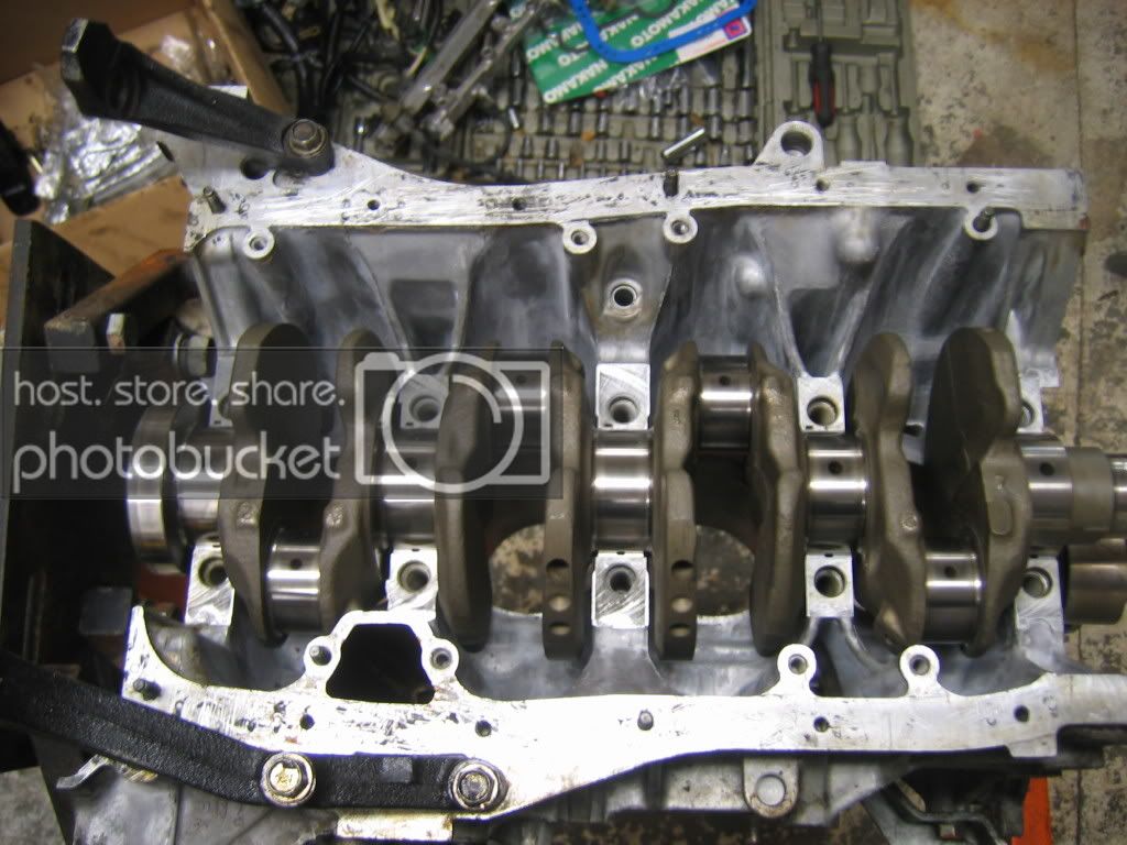

It's been really exciting finally putting this long build back together. I was a little scared on how my bearing clearances were going to be but everything was in spec! The main bearings were dead on and the rod bearings were just about at the right spot but still in good spec.

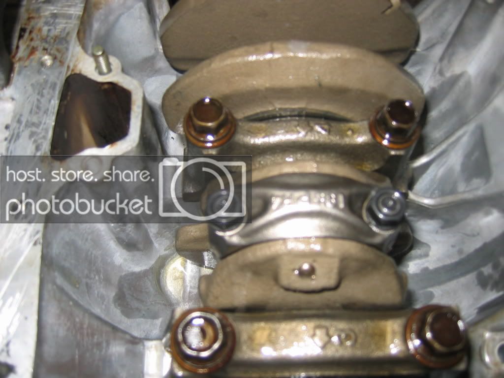

here is what the shotpeening does to the texture and color of the rods and caps.

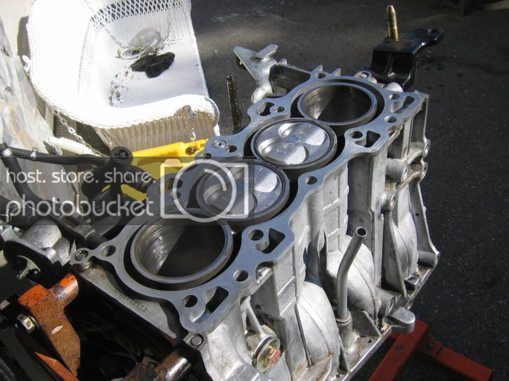

And the 3 pistons in
That is when I finished boring out my block. 83 mm each piston since I love torque. I blow trannies every month but it's worth it.

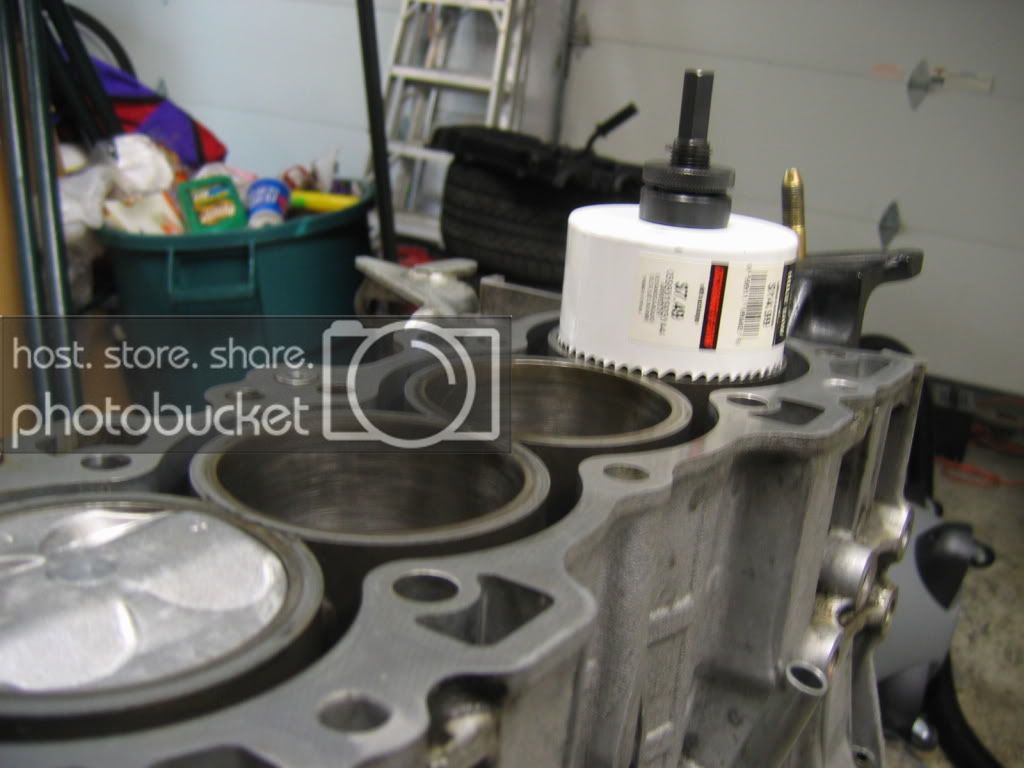

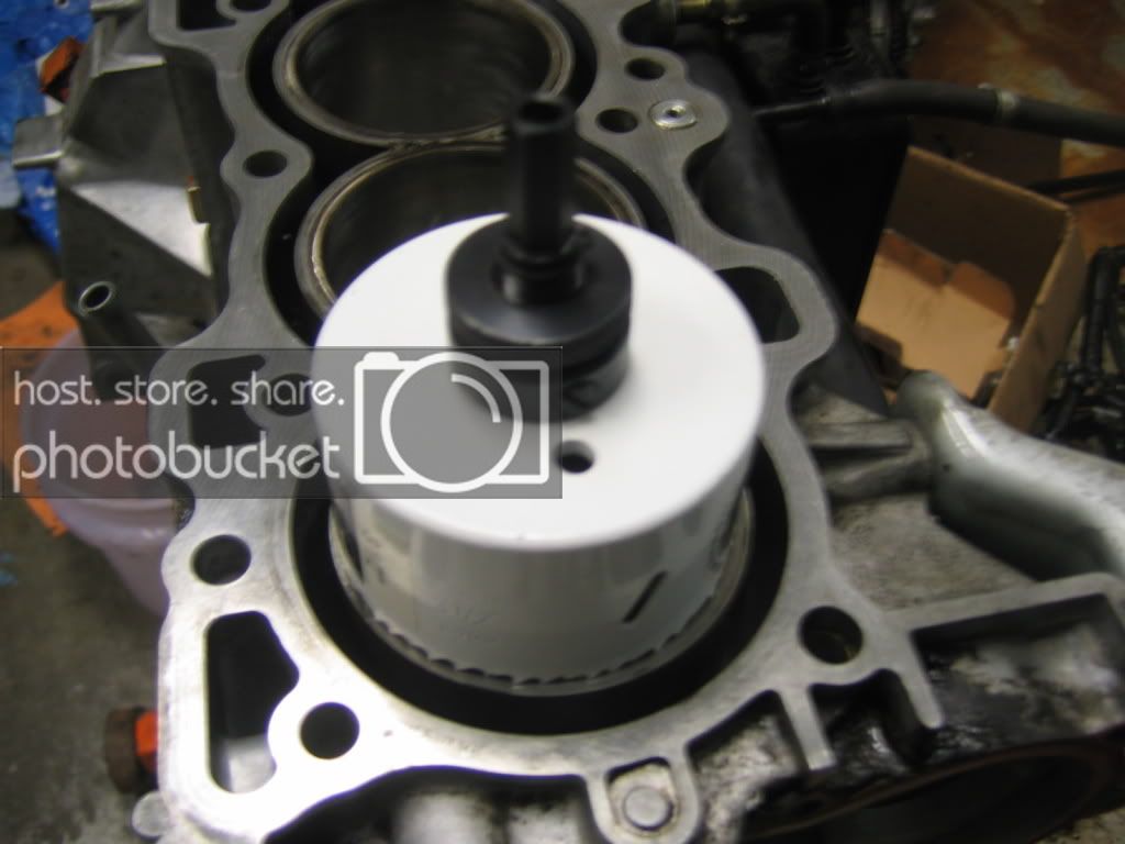

lol, just kidding about all that. I the hole saw to make moon cuts into my valve cover for the skunk2 cam gears.

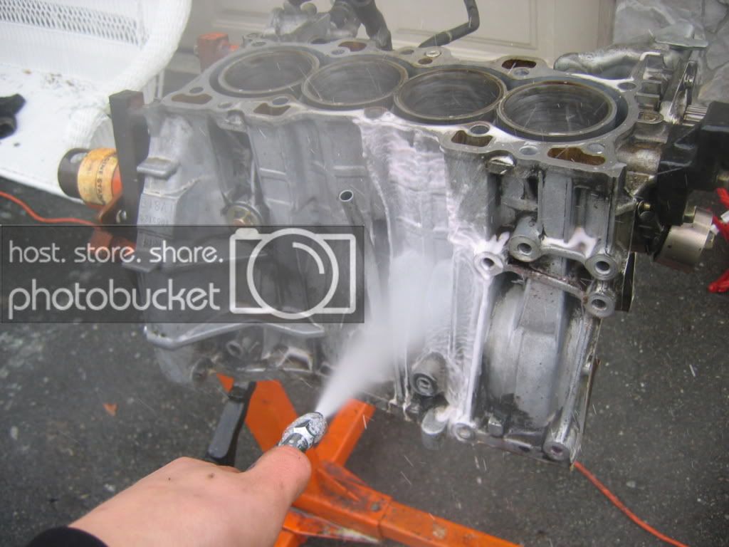

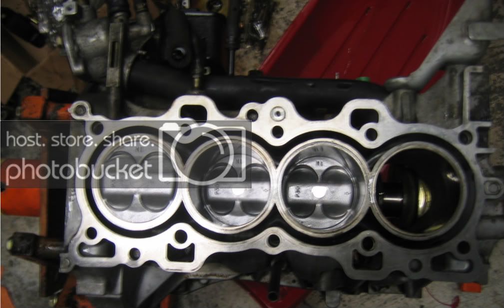

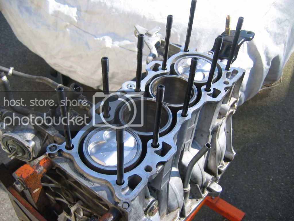

I just got off work and picked up my new piston rings. I put the piston in real quick and got some pictures of the almost complete motor.
Here are the pistons all in

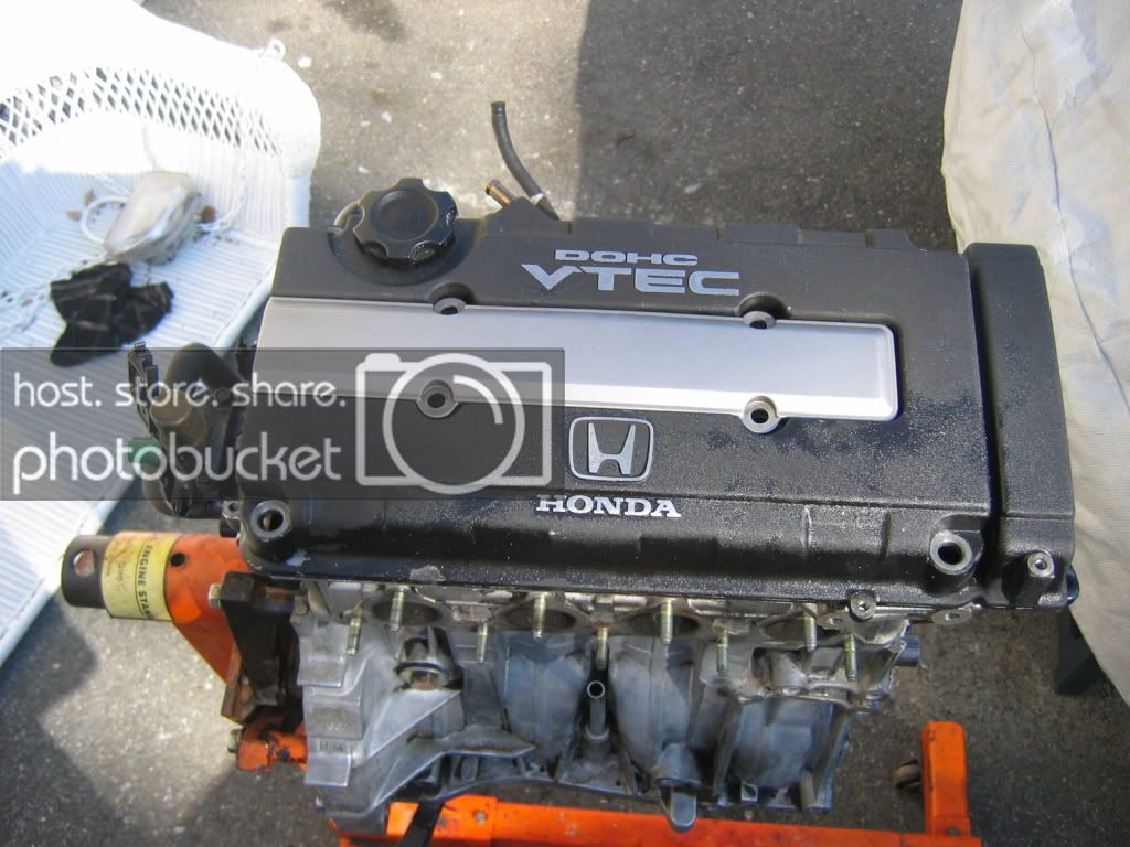

My new motor!!
I just have to do the following now
Put on the oil pump
Oil Pan
Finish putting new seals in the head
Put Water Pump on
Timing Belt
And all the other stuff like Intake Manifold and ******. I'm hopefully dropping it in next week!
