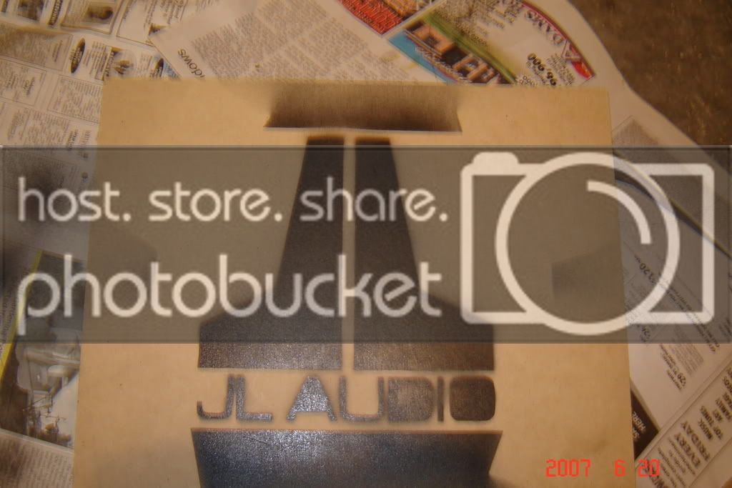

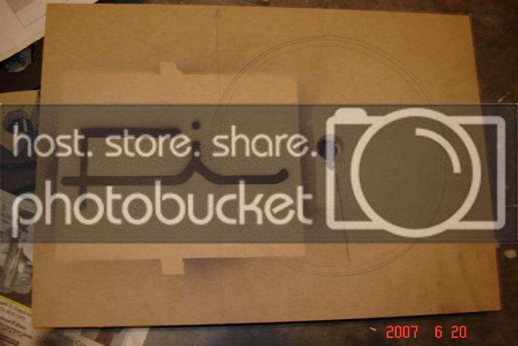

I am debating on putting the FI logo in the front or the JL audio logo. I cut out the FI logo from a picture that they had posted on their site. I used an exacto blade to get it to look nice. I then sprayed it on a practice board just to see how it would look:
I will do the JL logo tomorrow, and see how it looks.
